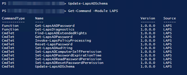

    2. Verify LAPS Configuration and 3. Update Active Directory Schema
    This was done during the LAPS new installation process, but here is the output we got. Keep in mind that it's the same as when it was installed.
    imagen
