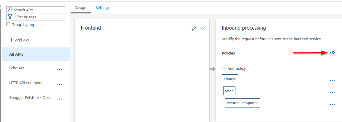

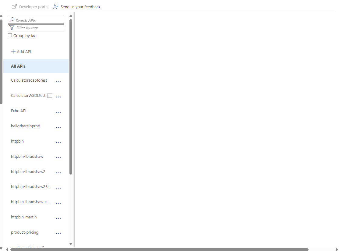

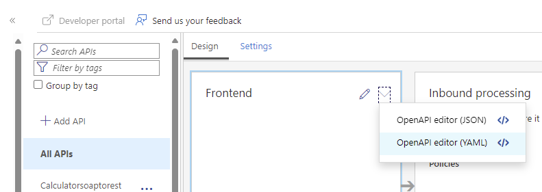

I do not want to go into each API and add this operation. Instead I want to add this under the "All APIs" section. However when I click "App APIs" , click frontend , openapi editor, it brings up a blank page.
Q: What is the correct way to add an operation which will be attached to ALL Apis?
