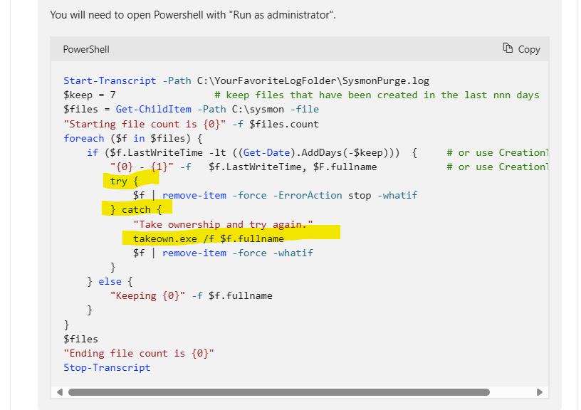

    ...I had built for you a Powershell script and requested that you set the scheduled task to run as the system account. If psexec can launch a command prompt that runs as the system account and allows you to access that folder, then a powershell script that is also running as the system account should also be able to access those files.
    Did you test the script?
