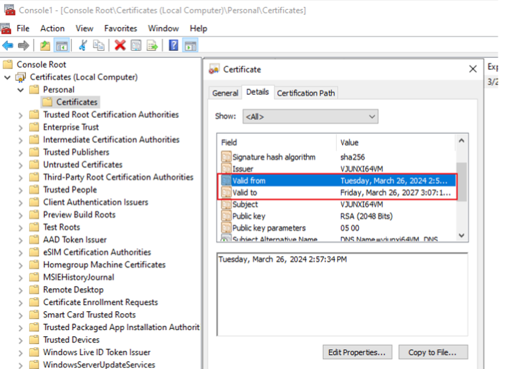

  1. ZoeHui-MSFT 41,496 Reputation points
    2024-12-02T06:01:18.7466667+00:00
    Hi @Boopathi S,
    You may run mmc and then check the certificate.
    Regards,
    Zoe Hui
