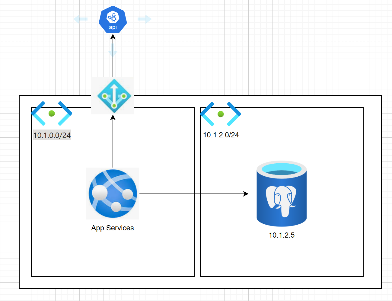

I have a VNET with 2 subnets:
  • web subnet: with Nat gateway integration (because i need fixed outbounf IPs for some external services IP whitelisting) wit app services that access external APIs but also access the PostgreSQL flexible DB on the other subnet
  • DB subnet: where the postGreSQL flexible server is deployed in Private Access VNET integration.
The connection string to the DB on the web services that access the DB is configured with the private IP of the DB server (10.1.2.5), so my understanding is that the traffic to the DB should not be going through te NAT Gateway but straight to that private IP?
I see a lot ot ingress/egress traffic through the NAT gateway (more than I would expect from traffic towards the external APIs), so it is making me think that may be for some reason the traffic to the DB is actually going through the NAT Gateway? Can anyone confirm if the traffic to the DB may be going through the NAT Gateway?
Cheers

    Yes, your understanding is correct.
    The way the flows would work, traffic towards the DB would not go through the NAT gateway, as on the DB connection string you are pointing directly to the private IP of the DB (10.1.2.5) which is configured on Private mode linked to that subnet.
