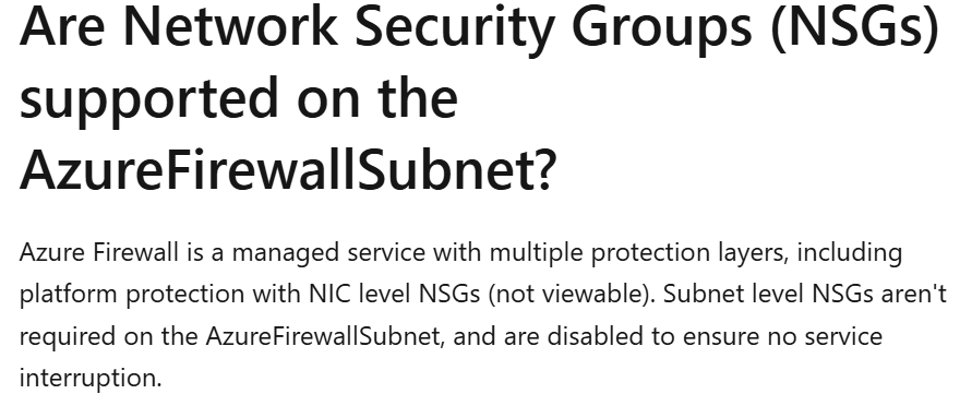

  1. Is it ok to use a NSG at Azure Firewall subnet level in a Virtual Network?

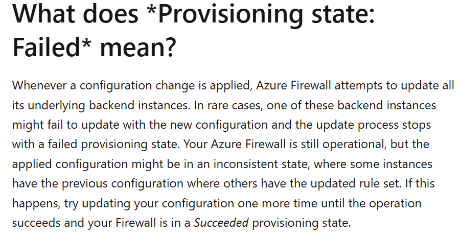

  2. I have made some changes to my Firewall and all of sudden, it is showing provisioning state failed. I don't know what went wrong.

  1. Sai Prasanna Sinde 6,645 Reputation points Microsoft External Staff Moderator
    2024-12-06T03:25:34.4933333+00:00
    Hi @Martinmajestic-3285,
    Welcome to Microsoft Q&A Platform. Thank you for reaching out & hope you are doing well.
    Adding to the points provided by Marcin Policht, I am adding some reference documents so that you can get a better understanding.
    For your reference: https://learn.microsoft.com/en-us/azure/firewall/firewall-faq?source=recommendations#are-network-security-groups--nsgs--supported-on-the-azurefirewallsubnetUser's image
    For your reference: https://learn.microsoft.com/en-us/azure/firewall/firewall-faq?source=recommendations#what-does--provisioning-state--failed--mean-
