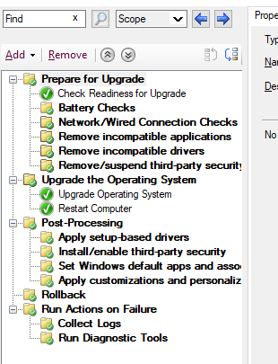

Here my TS

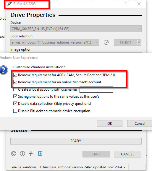

If I do it manually without SCCM TS, it works, I have created from Windows 11 24H2 with RUFUS a Boot Windows and selected without TPM. The RUFUS create a REG KEY on the
HKLM\SYSTEM\Setup\MoSetup
"AllowUpgradesWithUnsupportedTPMOrCPU "
I have copied that Boot Files into SCCM Directory and created a "Operation System Upgrade Package" and Create a TS from that Package and deploy it.

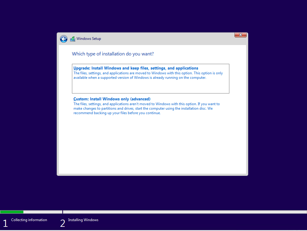

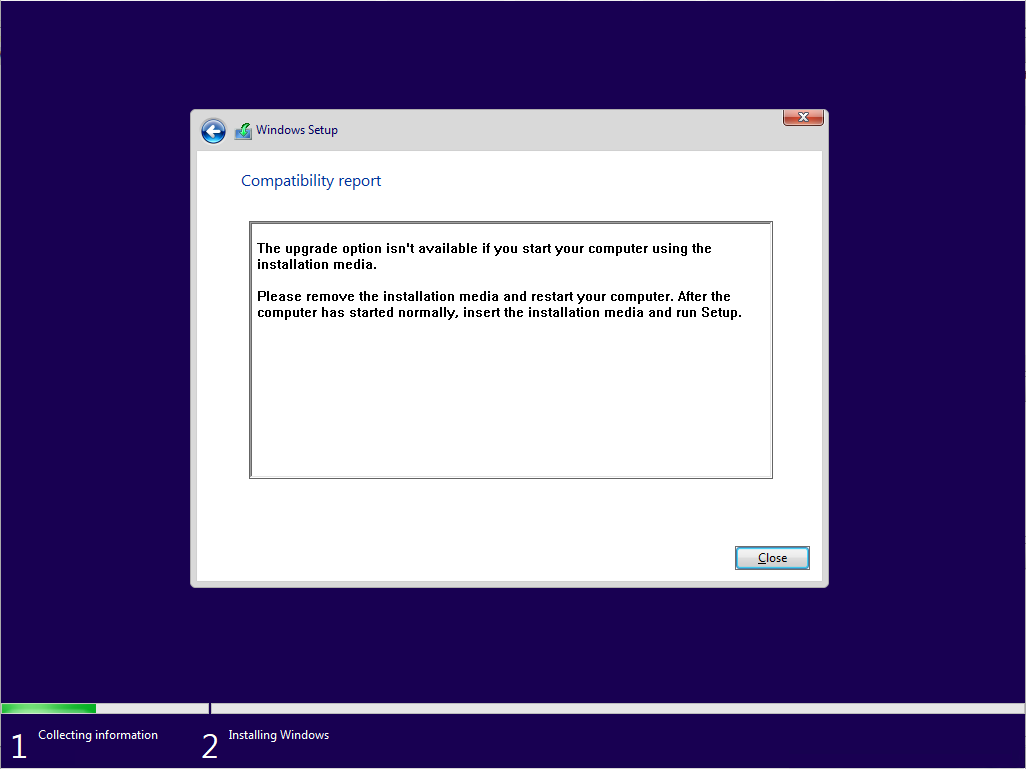

    For the installation media or .iso file, if we extract it, we will get boot.wim and install.wim and when we boot from the media, boot.wim is loaded firstly. In this environment, there is multiple way (in the web, not officially) to modify the registry to bypass the restriction of TPM, CPU core, memory, etc., just as Rufus did. Even we can bypass the TPM checking, if we go further, we will see the upgrade (to keep everything) is grayed out since it is not supported to upgrade from the installation media.
    Important: the boot.wim extract from the installation file cannot be used for SCCM as the boot image.
    So, based on the above, no matter we run the setup.exe from full OS or hack the boot image of the installation media, we cannot do the upgrade.
    As for SCCM, it uses winPE and write the (customized, modified) install.win to the hard disk directly. After the computer starts, it reads content from hard disk and does not check the restriction anymore. I'm afraid this is the only way to re-image the computer without TPM, though not officially recommended.
    In short, upgrading is not supported and re-imaging with SCCM is possible way.
