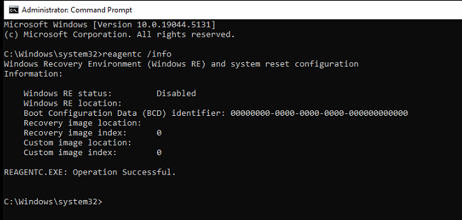

Hello All, Morning:
I would like to enable recovery using ReagentC in my windows LTSC 21H2 19044.5131 system using C# application so i set the app manifest by default launch ad admin.
I tried to launch the the batc file via this application but recovery is not set, if i launch the .bat file seperately the script works.
How can i launch the batch file from my app to eanble the recovery? do i need to tweak something in the registry?
Also another command prompt applciation but its not working. I have attached the codes in the notepad file : https://codefile.io/f/m11qxHjMZ1
Can somebody help with C# how to enable recovery? thanks in advance

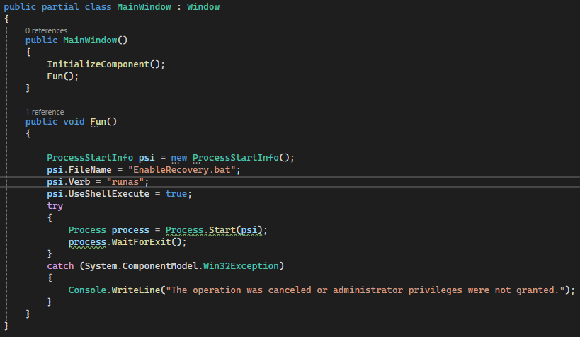

    Create a WPF program and add code.
    MainWindow.xaml.cs
    enter image description here

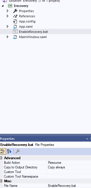

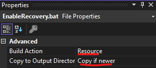

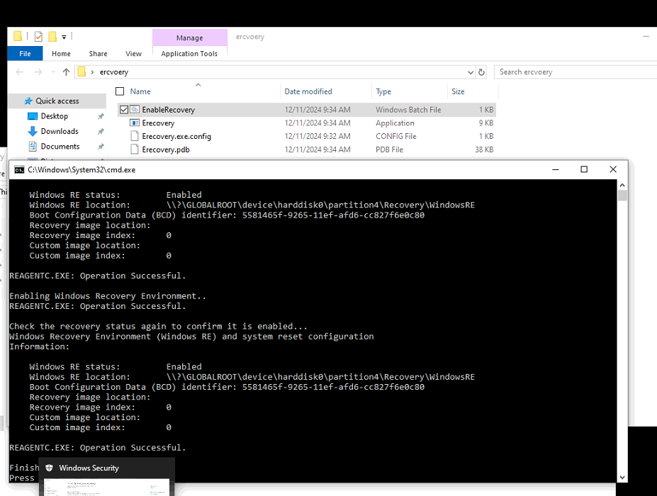

    Click EnableRecovery.bat and set its properties.
    Screenshot 2024-12-10 075714

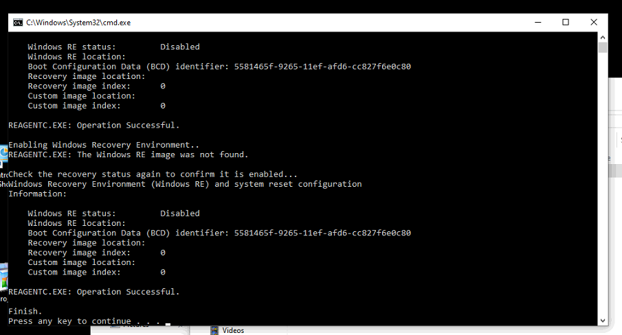

    Run the WPF program.
    Enter the command reagentc /info in the Command Prompt, and you could see Windows RE status of Recovery : Enabled. Screenshot 2024-12-10 080806
