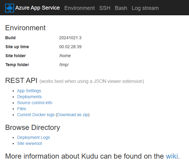

I have tried downloading the *docker.log file from Kudu, but that does not include any errors / tracebacks from the initialization.

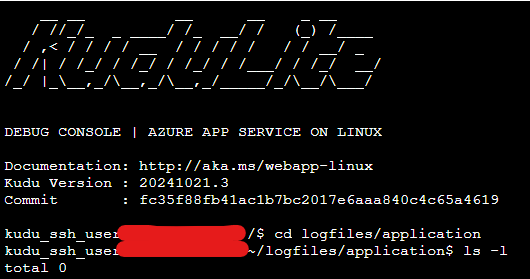

    To find the error that occurred during initialization, you can try checking the Function App's logs in Kudu. Here are the steps to do that:
    1. Go to your Function App in the Azure Portal.
    2. Click on "Platform features" in the left-hand menu.
    3. Under "Development Tools", click on "Advanced tools (Kudu)".
    4. In the Kudu dashboard, click on "Debug console" and select "CMD".
    5. Navigate to the "LogFiles" folder and then to the "Application" folder.
    6. Look for the log file with the most recent timestamp and open it.
    7. Search for any error messages or stack traces that occurred during the initialization of your Function App.
