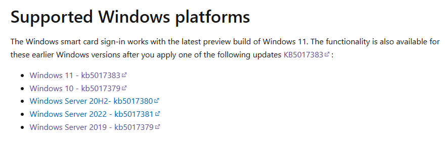

    To better understand the situation, please check if Entra CBA works in the browser. If you're unsure, I recommend starting there to ensure that the browser sign-in functions correctly first, as this will make troubleshooting easier. Once that is confirmed, please check if the windows version of your device lies under Supported Windows platforms as per below document.
    https://learn.microsoft.com/en-us/entra/identity/authentication/concept-certificate-based-authentication-smartcard#supported-windows-platforms
