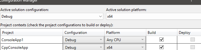

    However this is the solution configuration and it is possible that a project is using a different configuration so you should also go to Configuration Manager (from Solution Explorer by right clicking the solution) for your solution and ensure your project is building for Debug as well in this configuration.
    enter image description here
