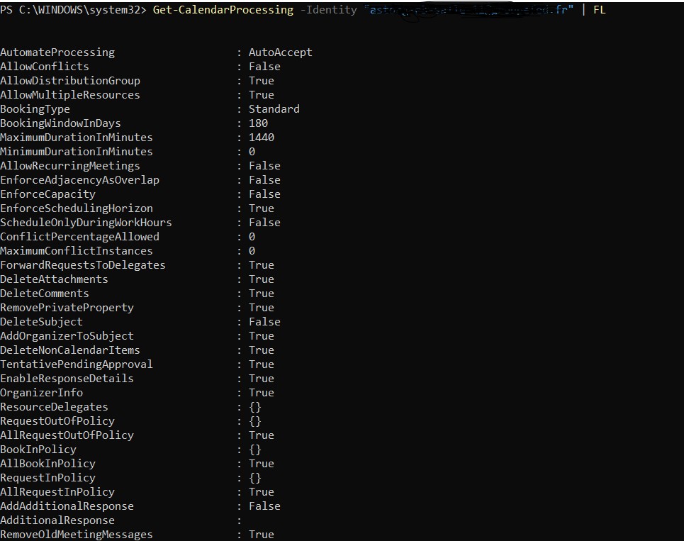

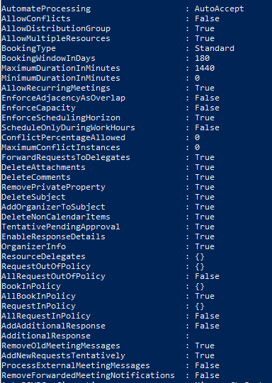

    1.Run the following PowerShell cmdlet to view the booking policy:
    Get-CalendarProcessing -Identity <resource mailbox> | FL
    2.You can investigate resource booking issues using the Booking Attendant log at this link:https://learn.microsoft.com/en-us/exchange/troubleshoot/calendars/use-resource-booking-attendant-logs
    To better solve your problem, I hope you can provide some screenshots of the reported errors.

    Regarding your first issue, the specific room mailbox might have configured with work hours restriction. If you try to book room in non-working hours, you will be denied.
    To check the work hours restriction, use the below cmdlet.
    Get-CalendarProcessing -Identity ******@contoso.com | select ScheduleOnlyDuringWorkHours
    If it returns true, you need to set it as False to allow booking all the time.
