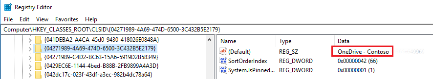

    I suggest you try to remove the -PCNAME OneDrive account from the registry:
    NOTE: Serious problems might occur if you modify the registry incorrectly. Before you modify it, please remember to back up the registry for restoration in case problems occur.
    Here is an article about how to back up and restore the registry in Windows:  https://support.microsoft.com/en-us/topic/how-to-back-up-and-restore-the-registry-in-windows-855140ad-e318-2a13-2829-d428a2ab0692
    1. Click Windows + R and enter regedit to open the Registry Editor.
    2. Navigate to HKEY_CLASSES_ROOT > CLSID. Inside the folder, please search (CTRL + F) for OneDrive.
    3. Find the OneDrive – PCName value and looks something like the screenshot below:
    4. Delete the folder.
    5. Restart the computer.
