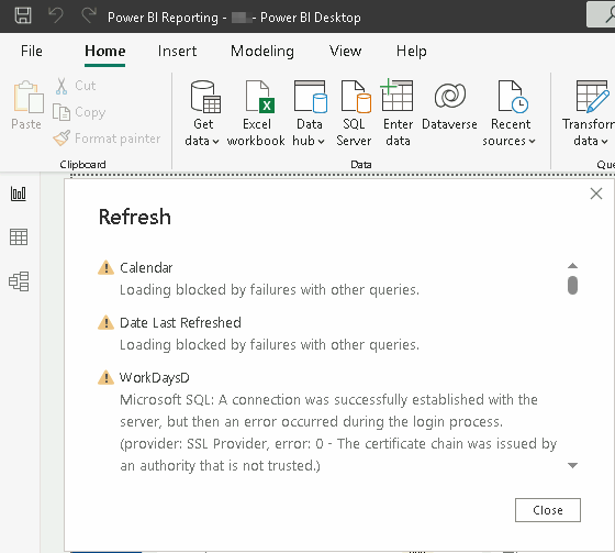

I’m encountering an SSL certificate chain issue when trying to connect to my SQL Server from a Power BI server. The server connects, but when I click refresh, this error appears. Below are the details:
Error Message:
Microsoft SQL: A connection was successfully established with the server, but then an error occurred during the login process. (provider: SSL Provider, error: 0 - The certificate chain was issued by an authority that is not trusted.)
The error occurs even when connecting from the Power BI on the same SQL Server machine.
Environment:
  • SQL Server Version: SQL Server 2019 (15.0.4153.1)
  • Client Application: Power BI
  • Server OS: Windows Server 2019 Datacenter
  • Client OS: Windows 10 / Windows 11
Actions Taken:
  1. Verified SSL configuration on SQL Server.
  2. Installed the SSL certificate on the client machine and added it to trusted root certificate authorities.
  3. Tried different connection string options with Encrypt=true and TrustServerCertificate=true. 4. Checked firewall and network settings.
I’ve exhausted my current options and would greatly appreciate any suggestions. Thank you!
Screenshot from 2025-02-12 21-09-52 (another copy)

  1. ZoeHui-MSFT 41,536 Reputation points
    2025-02-14T02:02:17.32+00:00
    Hi @Suchith D
    Go to File->Options and Settings -> Data Source Settings in Power BI Desktop, select your SQL data source and tick "Encrypt connections".
    Or go to other source, use OLEDB driver for a try.
    Regards,
    Zoe Hui
  2. Erland Sommarskog 128.7K Reputation points MVP Volunteer Moderator
    2025-02-13T22:08:30+00:00
    Sounds like you've done everything right. But apparently you haven't after all.
    Just to check, how does things look at the server? It should look like this:
    That is, a name should appear in the certificate drop-down. It should not be blank.
