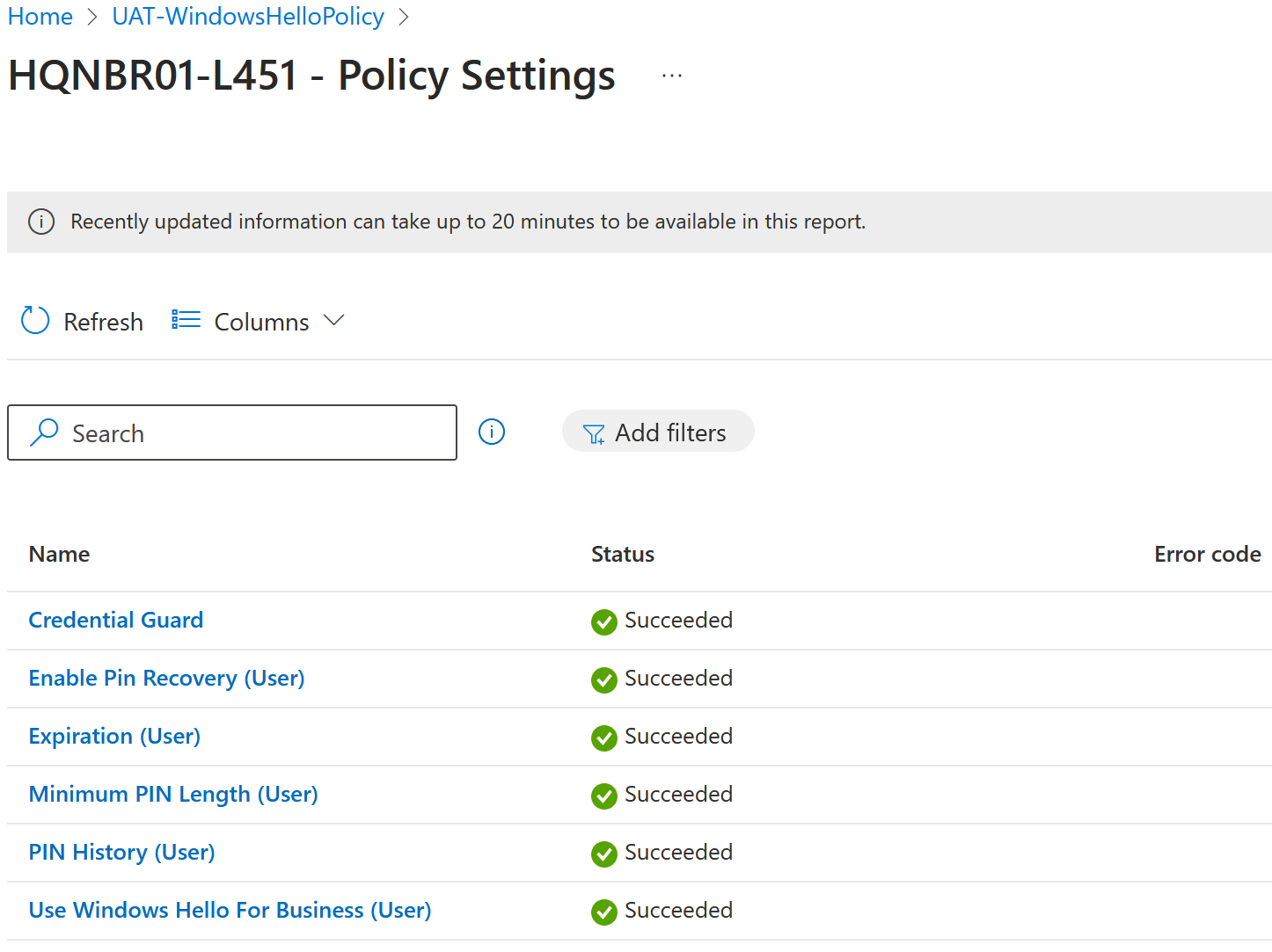

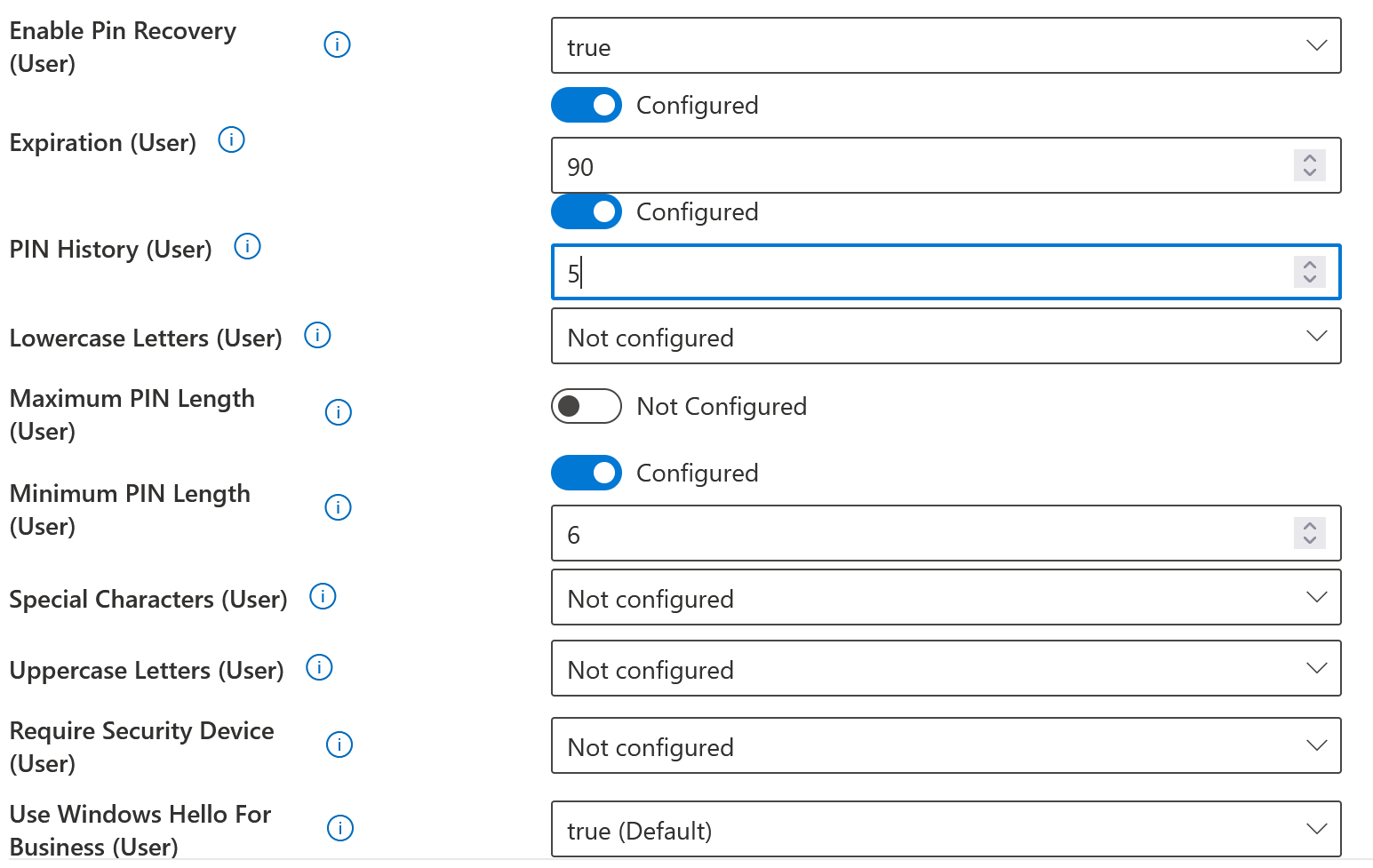

We have configured an Account Protection Policy via Microsoft Intune to enforce Windows Hello PIN settings. While most settings are applied successfully, the PIN history restriction does not work. Our requirement is to prevent users from reusing the last 5 PINs when they change their PIN. However, users can still reuse their previous PINs despite the policy.
Troubleshooting Steps Taken:

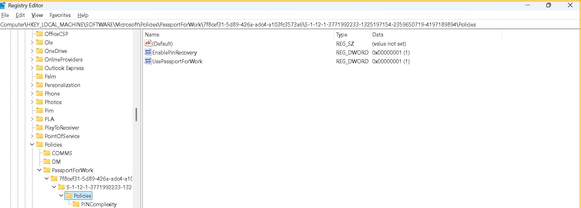

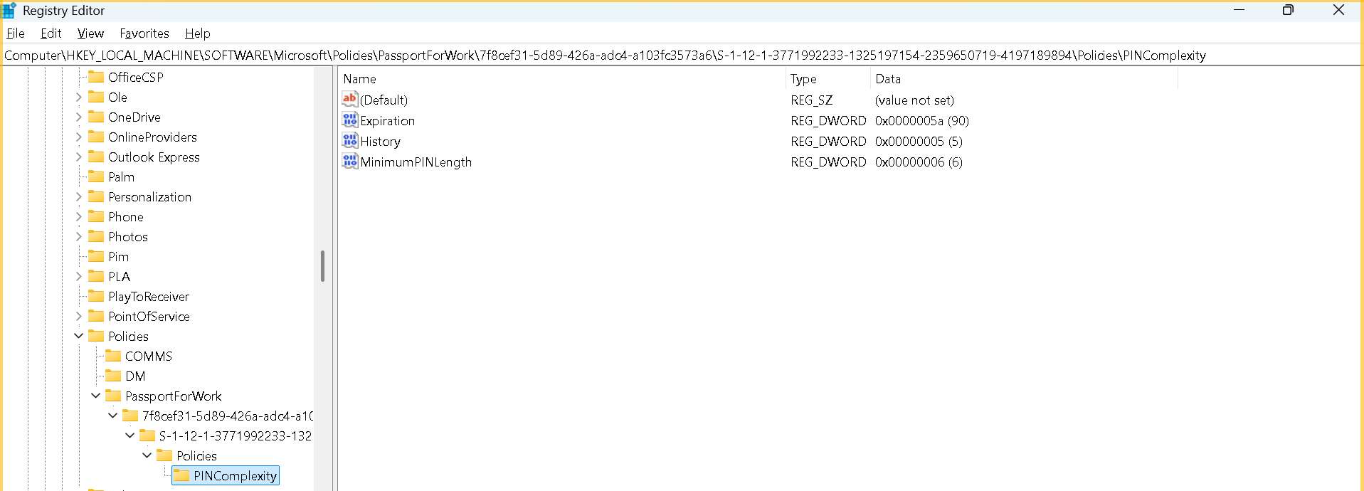

✅ Verified policy assignment report in Intune – The policy is successfully deployed. ✅ Checked the registry key on affected devices:
  • HKEY_LOCAL_MACHINE\SOFTWARE\Policies\Microsoft\PassportForWork\PINComplexity
The History value is correctly set to 5. ✅ Ensured that the devices have synced properly with Intune. ✅ Tested on multiple devices, but users can still reuse old PINs.
