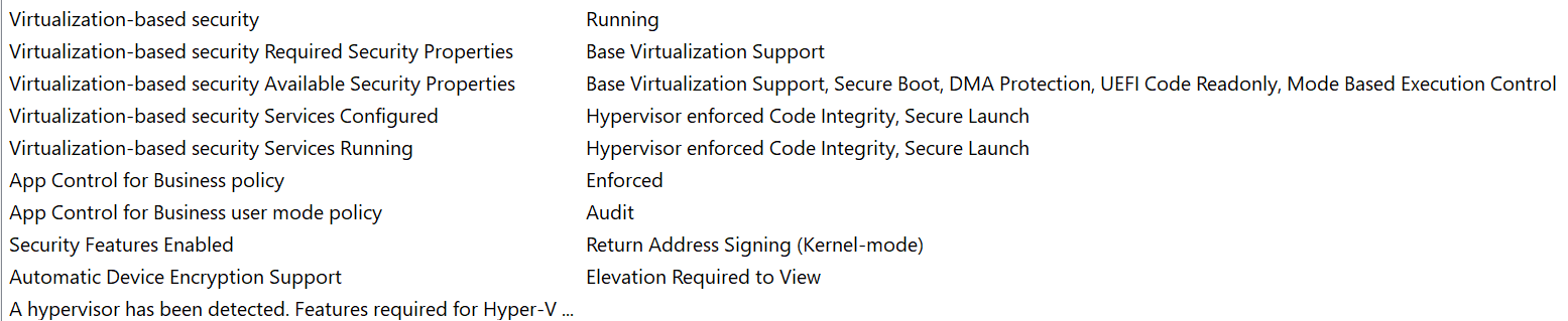

My Virtualization settings are:
Windows for business | Windows Client for IT Pros | Storage high availability | Virtualization and Hyper-V

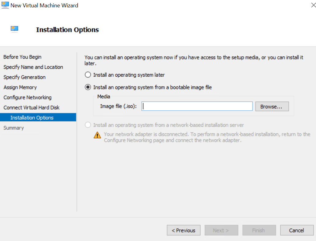

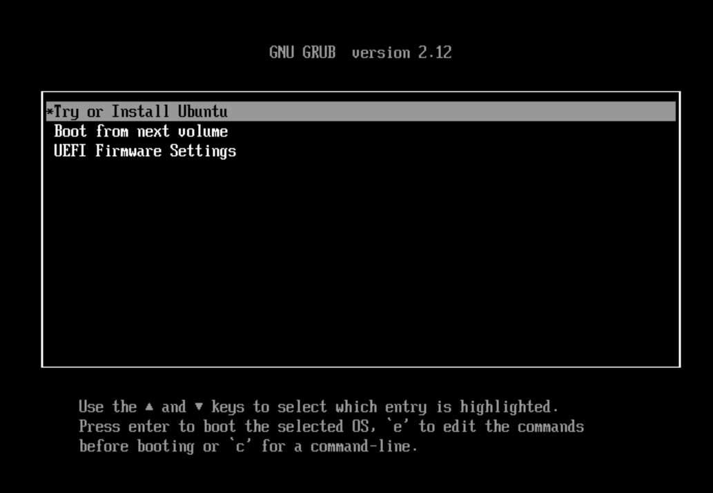

    Yes, I did select the local path as shown in the figure. Before I started the VM I disabled Secure Boot. After that I started the VM and quickly pressed the space bar mutiple times, until the installation menu showed:
    When I select 'Try or Install Ubuntu' a black screen appears with a cursor and nothing happens.

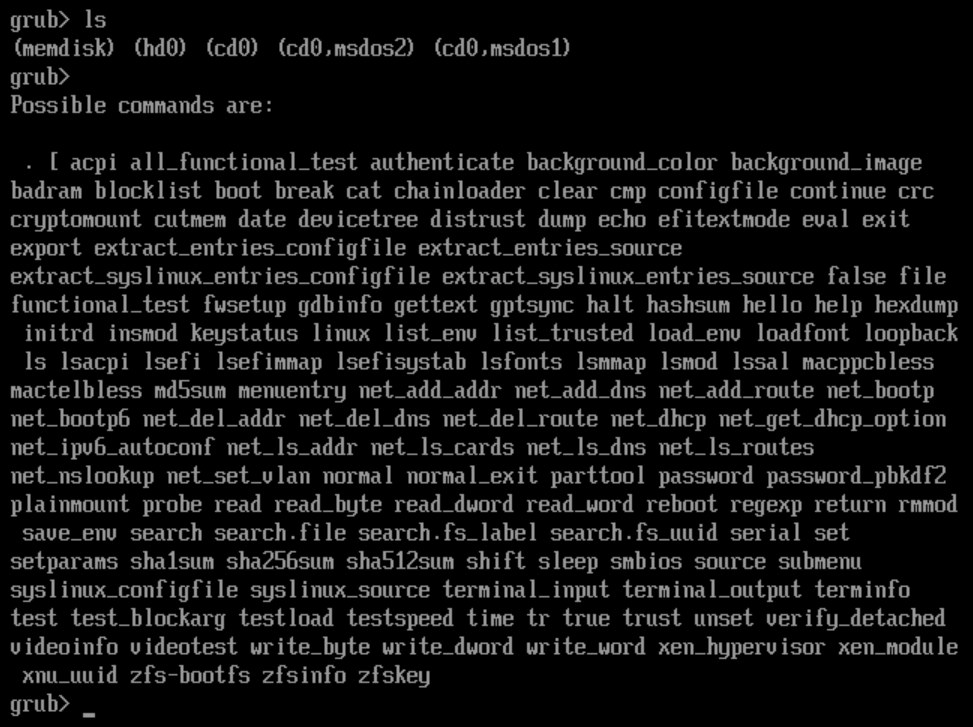

    Btw, I can open the command-line:

    2025-02-20T15:35:19+00:00
    Hello,
    Hello, Did you download the Ubuntu image file and then select the local path of the image file in the tab as shown in the figure below? I suggest that you try to quickly press the space bar when starting the VM to see if you can enter the installation boot interface.
    Best Regards
