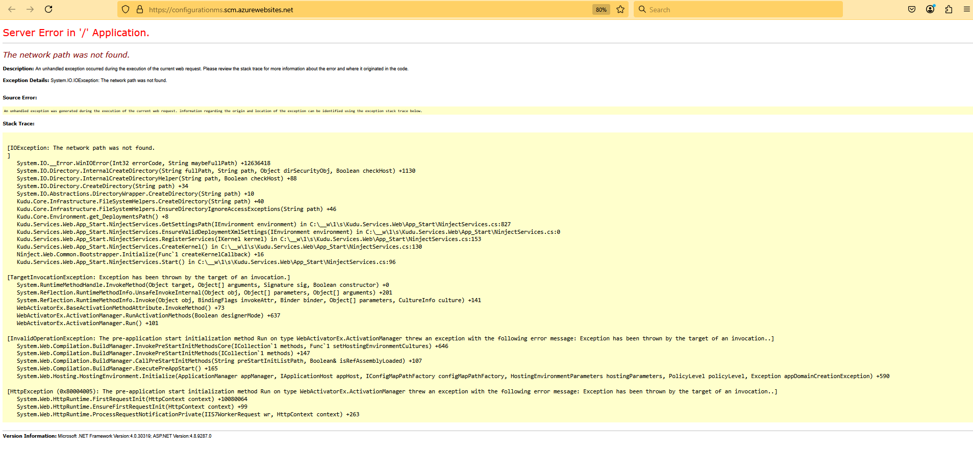

Hi, for some reason, one of our function stopped working we have this error
System.Private.CoreLib: The network path was not found. : 'C:\home\site\wwwroot\host.json'.
We try restart the function app but didn't work
Could you please check this image error?

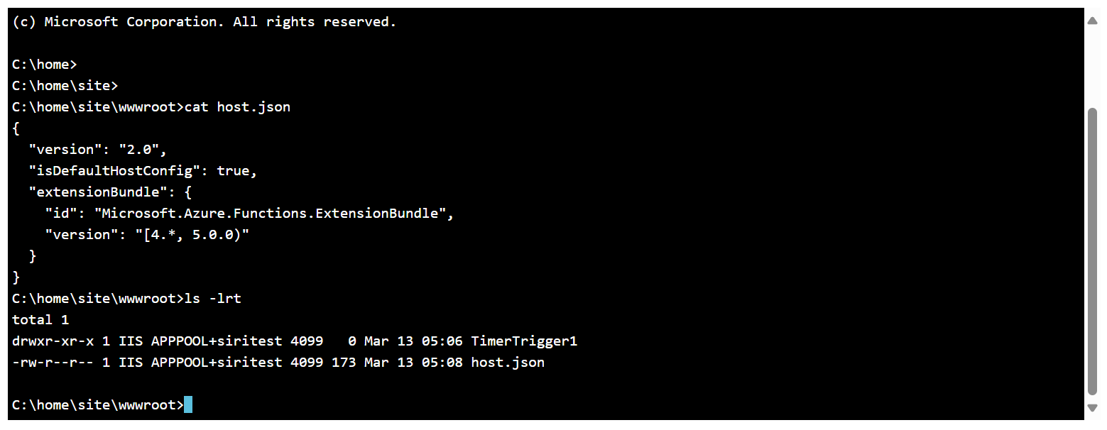

    Check if host.json Exists:
    • Make sure the host.json file is in the root directory of your function app. It should be located in the wwwroot folder.
    • You can verify this using the Kudu console in the Azure portal:
      • Navigate to Development Tools > Advanced Tools (Kudu) > Debug Console > CMD, and check if host.json is at C:\home\site\wwwroot\host.json
    • If the host.json file is missing or damaged, redeploy your function app to restore it.
    • If you've already restarted the function, try doing it again after redeploying the app to refresh the settings.
    • Ensure there are no permission issues that might be blocking access to the file or directory.
