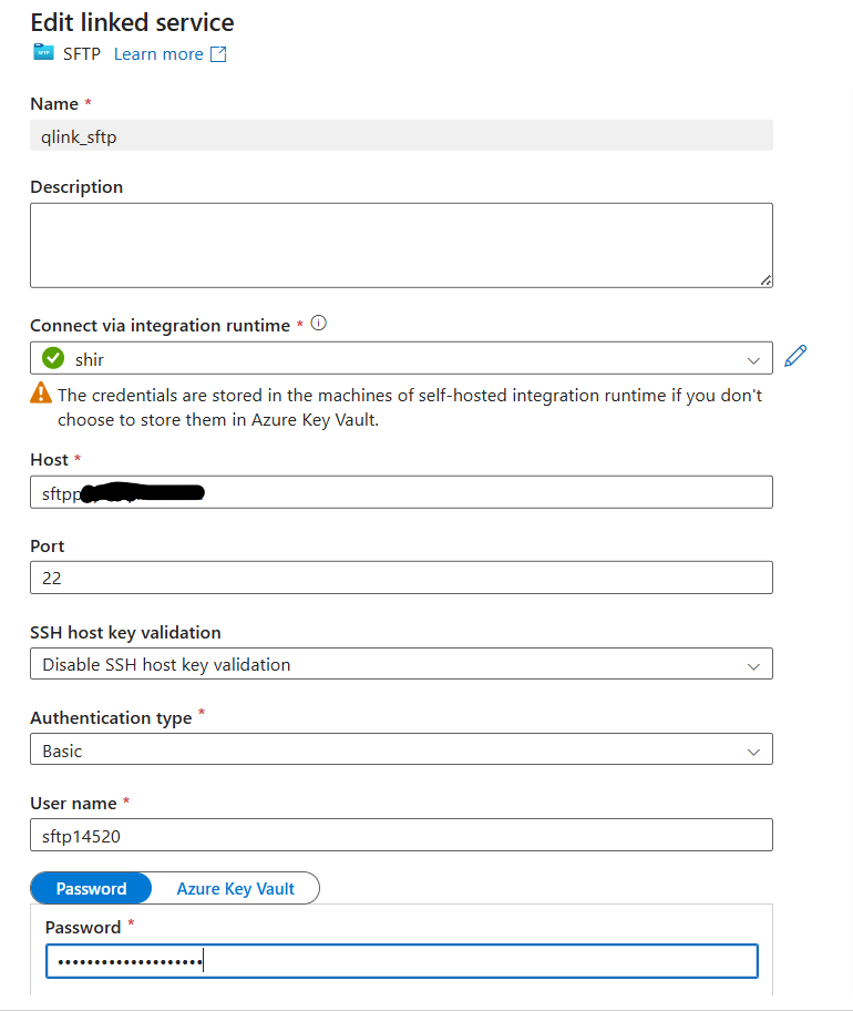

I have to reach to the client sftp through my adf linked service. Client needs a single static ip to whitelist on their end.
I created a SHIR within adf in a subnet that further is associated with a NAT gateway public ip.
I requested the client to whitelist my nat public IP.
I logged in to the VM, search for 'whats my ip?' It shows the nat gw IP.
But still my linked service fails.

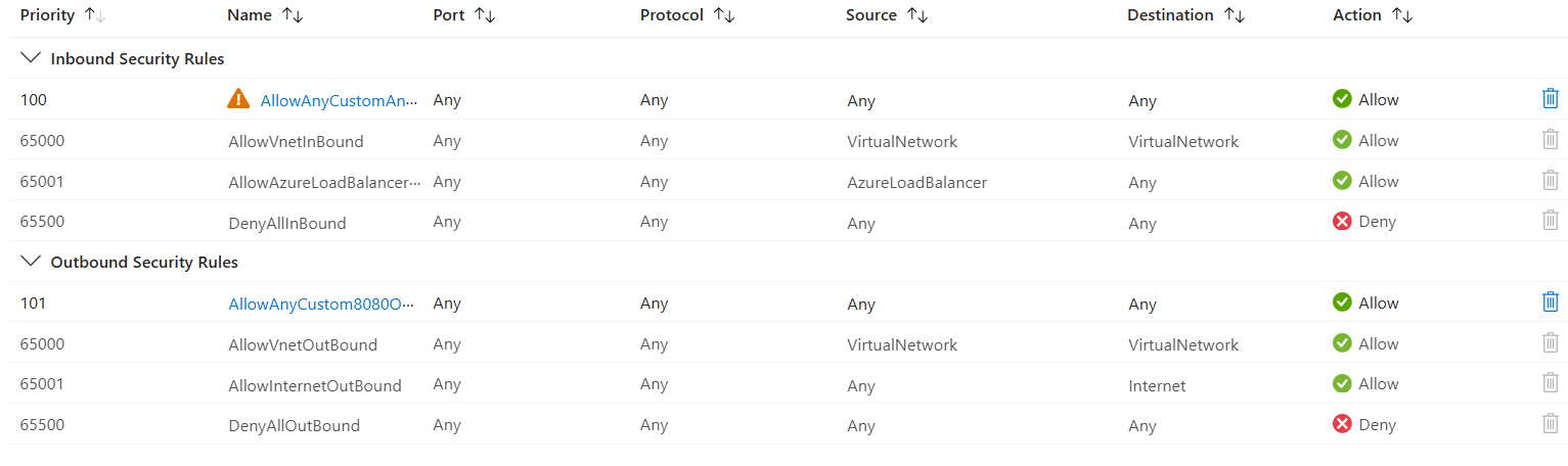

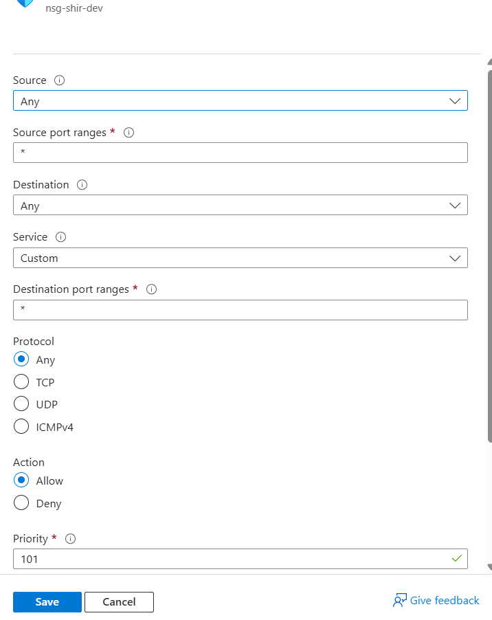

      • Outbound Rules: Check the NSG associated with the subnet of the SHIR VM to ensure that outbound traffic to the SFTP server’s IP and port (usually port 22 for SFTP) is allowed.
    • Although not directly related to outbound traffic, ensure that there are no restrictive inbound rules that might be affecting the SHIR’s ability to communicate.

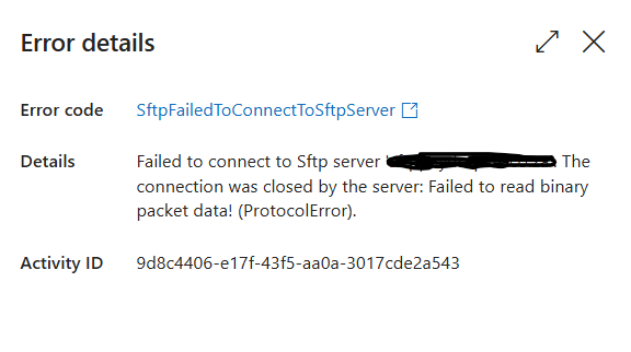

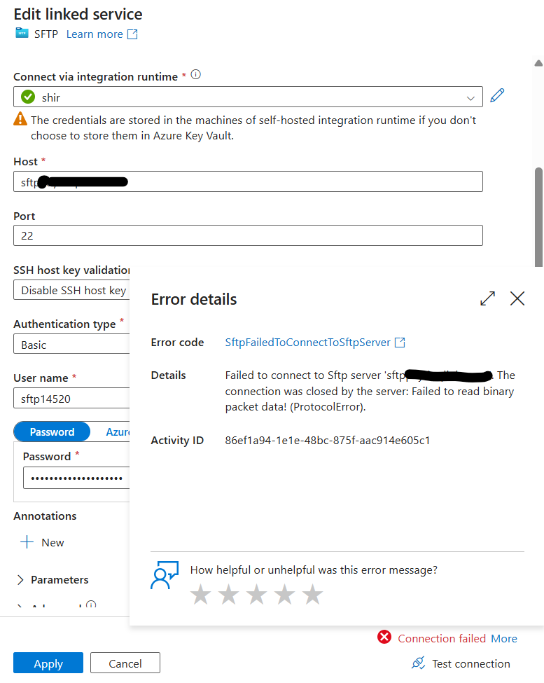

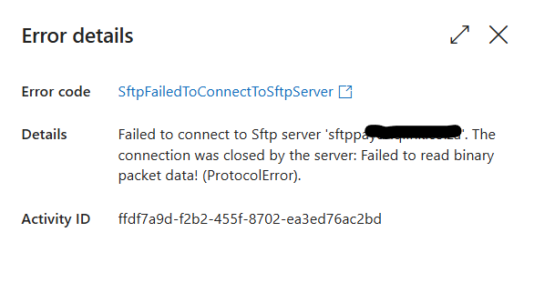

    I understand you're experiencing issues connecting to the SFTP server, as indicated by the error code: SftpFailedToConnectToSftpServer. Here are some troubleshooting steps that might help you:
    Firewalls and NSG Configuration - Check NSG Rules: Ensure that the NSG rules allow traffic to the SFTP server. Source: Any Source Port Ranges: * Destination: SFTP Server IP (ensure it’s correctly configured) Destination Port Ranges: 22 (the default for SFTP) Action: Allow Priority: Make sure it has a higher priority than any deny rules.

    Protocol and Configuration Protocol Check - Confirm that the SFTP protocol is correctly implemented on the server. Binary Data Issue: The error suggests a potential issue with reading binary packet data. Verify that the server configuration aligns with the client’s expectations for data transmission.
    Logs and Additional Diagnostics Check Server Logs - Look for any relevant logs on the SFTP server that might give additional details on the connection issue. Activity ID: Use the Activity ID (9d8c4406-e17f-43f5-aa0a-3017cde2a543) for reference during support calls or further investigation.
