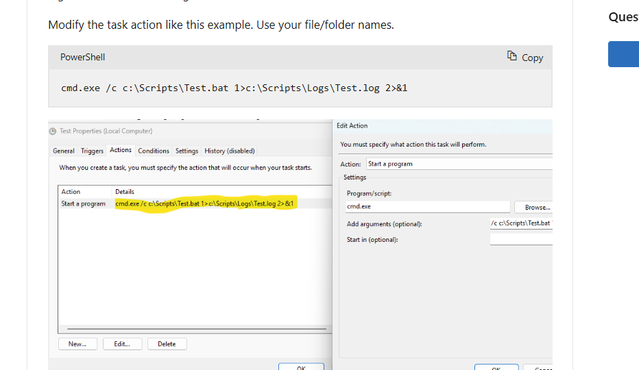

    You need to capture stdout and stderr to see what output the bat file produces.
    See my answer to this question as to how to configure the task actions to do that.
    https://learn.microsoft.com/en-us/answers/questions/2141466/how-to-run-a-task-with-task-scheduler
