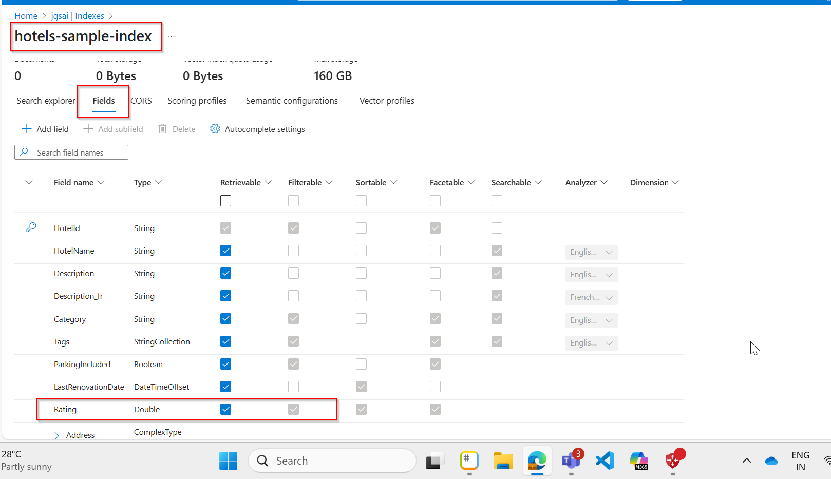

    In your case the requirement is filter the documents in AI search based on the tags, for that you should be having the field to store tag values in your search index and make it Filterable.
    Above I am having field Rating and made filterable, similarly you create tags field.

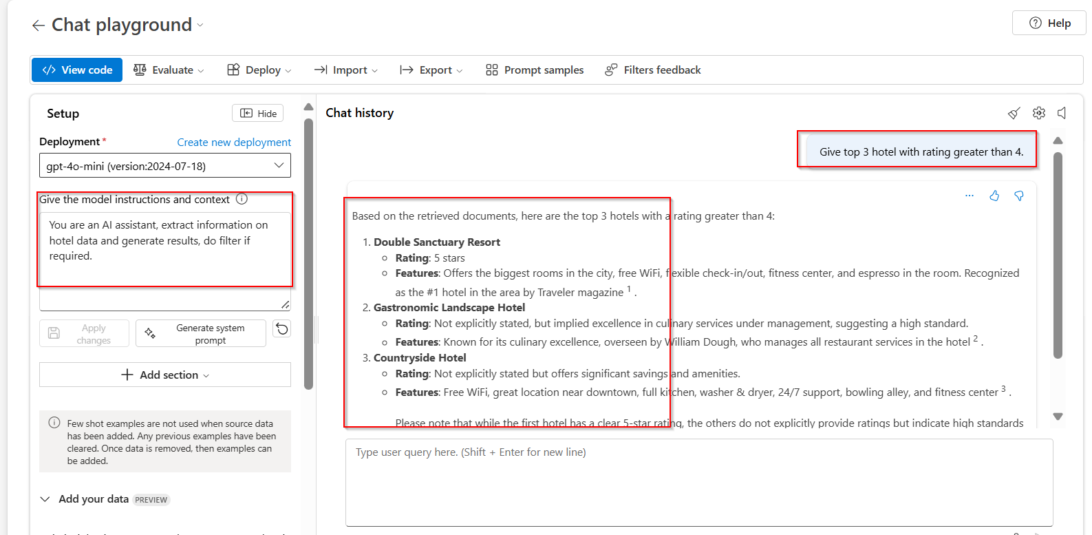

    Here, i have also added system message in the left side, same kind of message you should add on your data according to your requirement.
    Next, we have a deploy option which directly create a web app for you with added data source.
    Please try above and if find any query do let us know in comments or private message.
