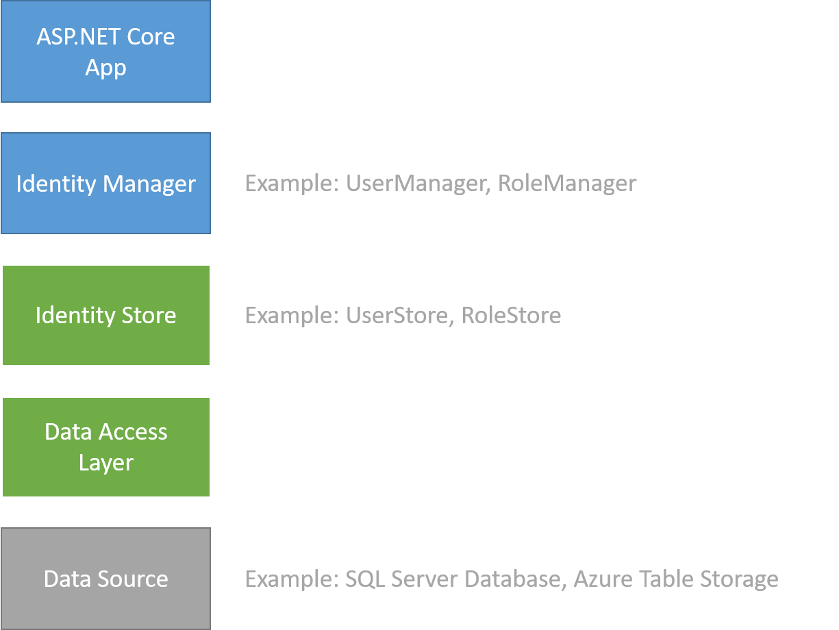

  1. SurferOnWww 4,706 Reputation points
    2025-05-29T02:15:17.19+00:00
    I'm curious about in which layer I should write hashing part?
    In the ASP.NET Core Identity, password hashing (PBKDF2 with HMAC-SHA256, 128-bit salt, 256-bit subkey, 10000 iterations) is taken care by the Identity Manager Layer.
    enter image description here
    See the Microsoft document Custom storage providers for ASP.NET Core Identity.
    Why don't you consider customizing the ASP.NET Core Identity? As mentioned in the above document you will be able to use a different data access approach, such as Dapper.
    You will have to create only the data source, the data access layer, and the store classes that interact with this data access layer (the green and grey boxes in the diagram above).
    Other than password hashing, the functionalities available in the ASP.NET Core Identity such as issue of authentication cookie, redirect to login page, validation of user name and password, prevention of duplicated user name, persistence and sliding expiration will be provided by the Identity Manager and ASP.NET Core App layers.
    Blow is a sample code of UserStore in Identity Store layer. The code uses EF Core. You will be able to rewrite the code to use Dapper instead of EF Core.
