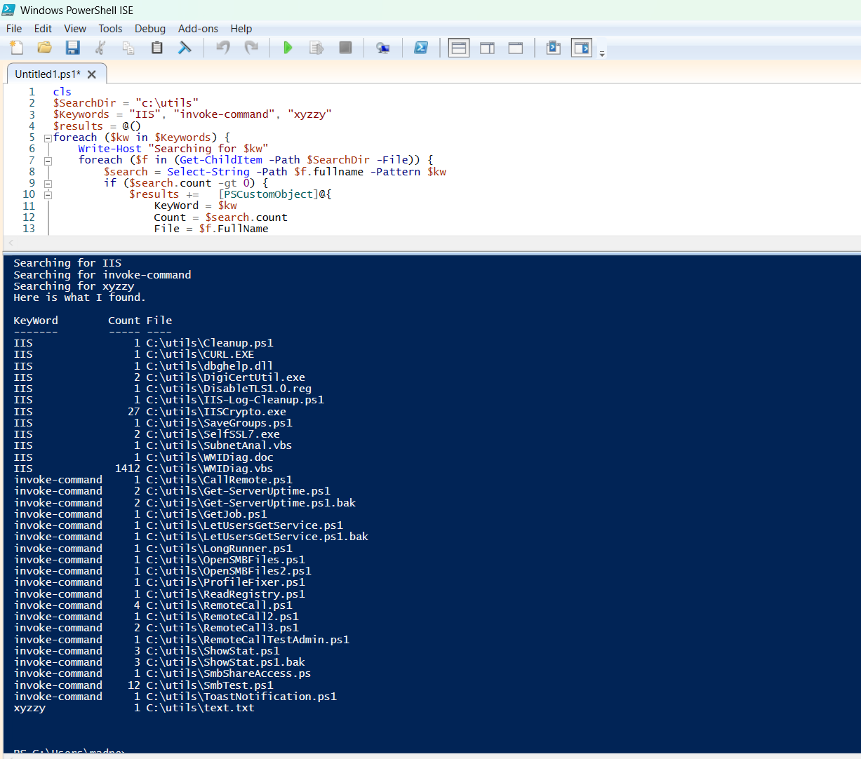

    cls
    $SearchDir = "c:\utils"
    $Keywords = "IIS", "invoke-command", "xyzzy"
    $results = @()
    foreach ($kw in $Keywords) {
        Write-Host "Searching for $kw"
        foreach ($f in (Get-ChildItem -Path $SearchDir -recurse -File)) {
            $search = Select-String -Path $f.fullname -Pattern $kw
            if ($search.count -gt 0) {
                $results +=   [PSCustomObject]@{
                    KeyWord = $kw
                    Count = $search.count
                    File = $f.FullName
    Write-Host "Here is what I found."
    $results                                    # show the results
    # Uncomment to save the results to a file
    # $results | Out-File C:\Temp\results.txt
    # $results | Export-Csv -Path "c:\temp\results.csv" -NoTypeInformation
    Use Powershell_ISE to develop and test the code.
