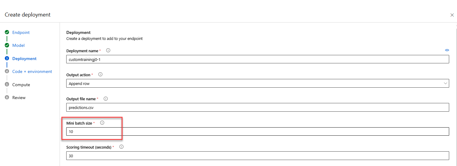

I keep getting this error when I try running a batch scoring job in Azure ML:
ValueError: Invalid input data type to parse. Expected: <class 'dict'> but got <class 'azureml_common.parallel_run.mini_batch.MiniBatch'>

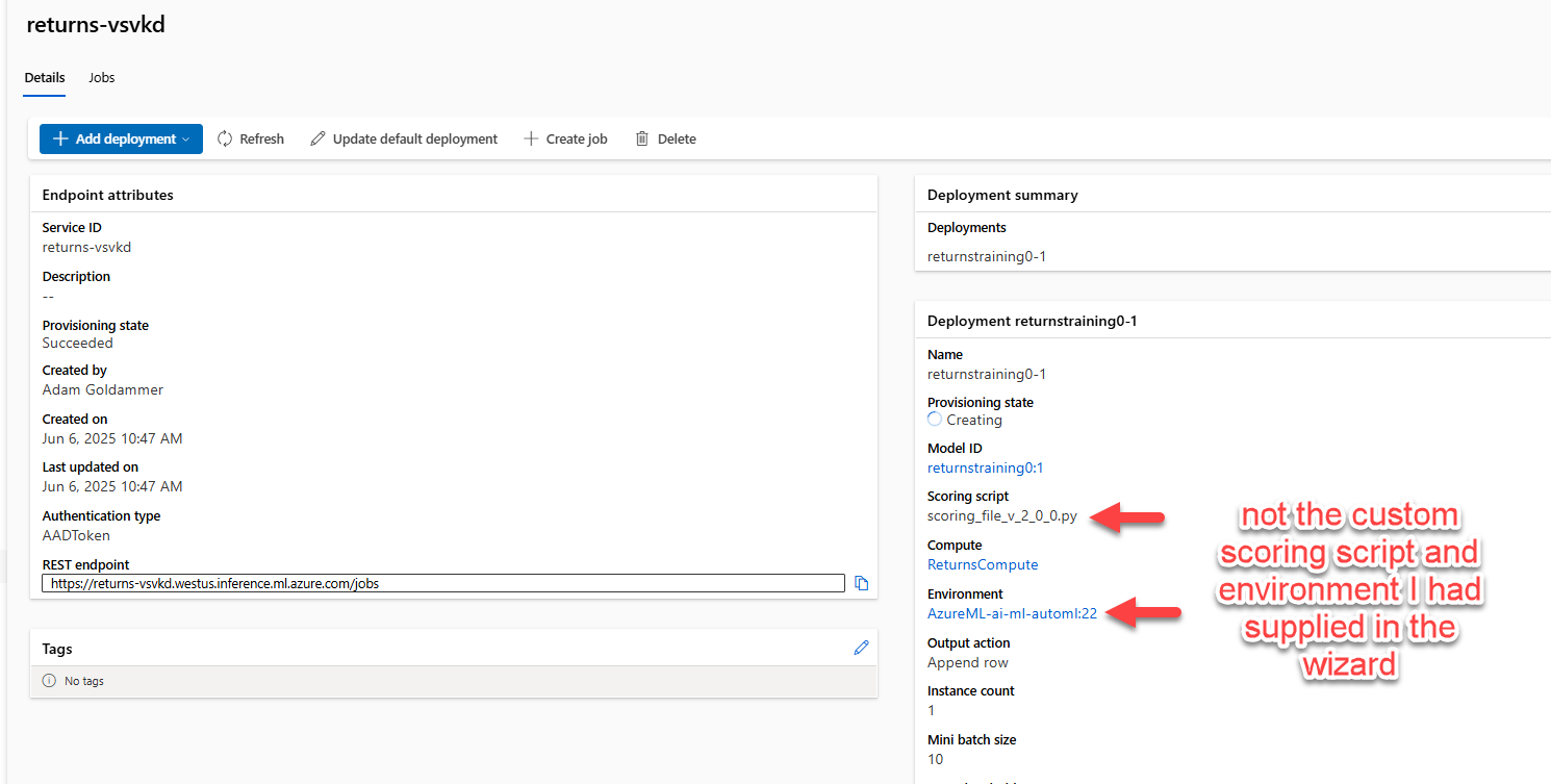

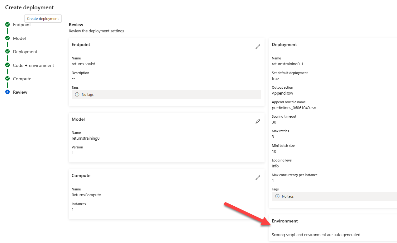

It's strange because I had successfully run several jobs previously and then all of a sudden I started to encounter this. Please note that I am using the auto-generated scoring script and environment provided via the Azure ML wizard.
I am self-taught on a lot of this so am leaning heavily on the Azure ML UI. My belief is that I could work around it by using a custom scoring script and environment but so far those attempts have failed.
