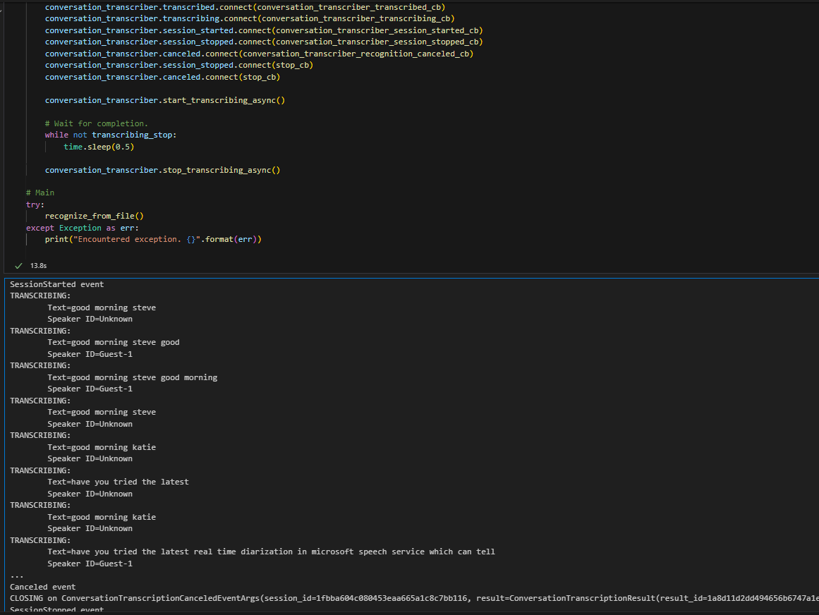

    I reproduced the issue using the Azure Speech SDK with the ConversationTranscriber class and confirmed it works correctly with the following approach: ensure you are using the latest version of the SDK, set the diarization property via speech_config.set_property with PropertyId.SpeechServiceResponse_DiarizeIntermediateResults, and instantiate the ConversationTranscriber from the speechsdk.transcription namespace. The sample code processes audio input, outputs speaker diarization results, and completes without errors. Please verify your environment uses the latest SDK and your code follows this pattern.

    Here is the output I received when running this code:User's image
    I hope this helps resolve your issue. Please ensure you have the latest Speech SDK installed, and feel free to reach out if you have any further questions.
