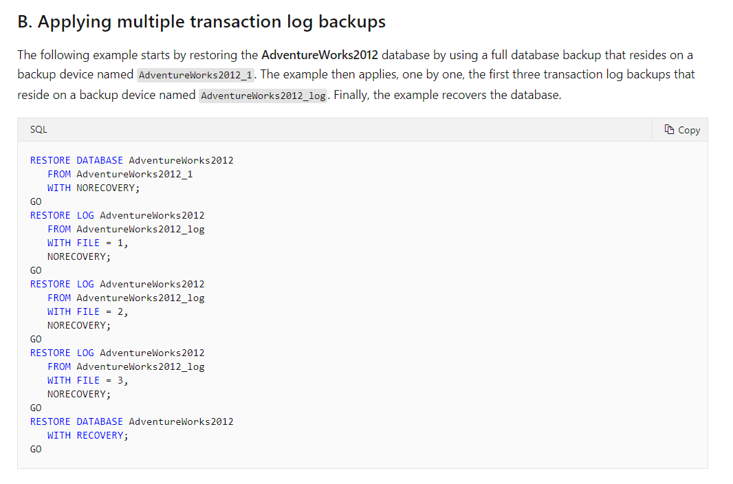

    When you prepare to restore a database, you need to restore a full database backup first, and then restore transaction log backups in order. And if you have a lot of transaction log need to restore, please refer to Restore a Transaction Log Backup (SQL Server), see below:
    If you just need to restore last transaction log, you can use below T-SQL, and then database will get online after restore has been completed:
    RESTORE LOG <database_name> FROM <backup_device> WITH RECOVERY;
