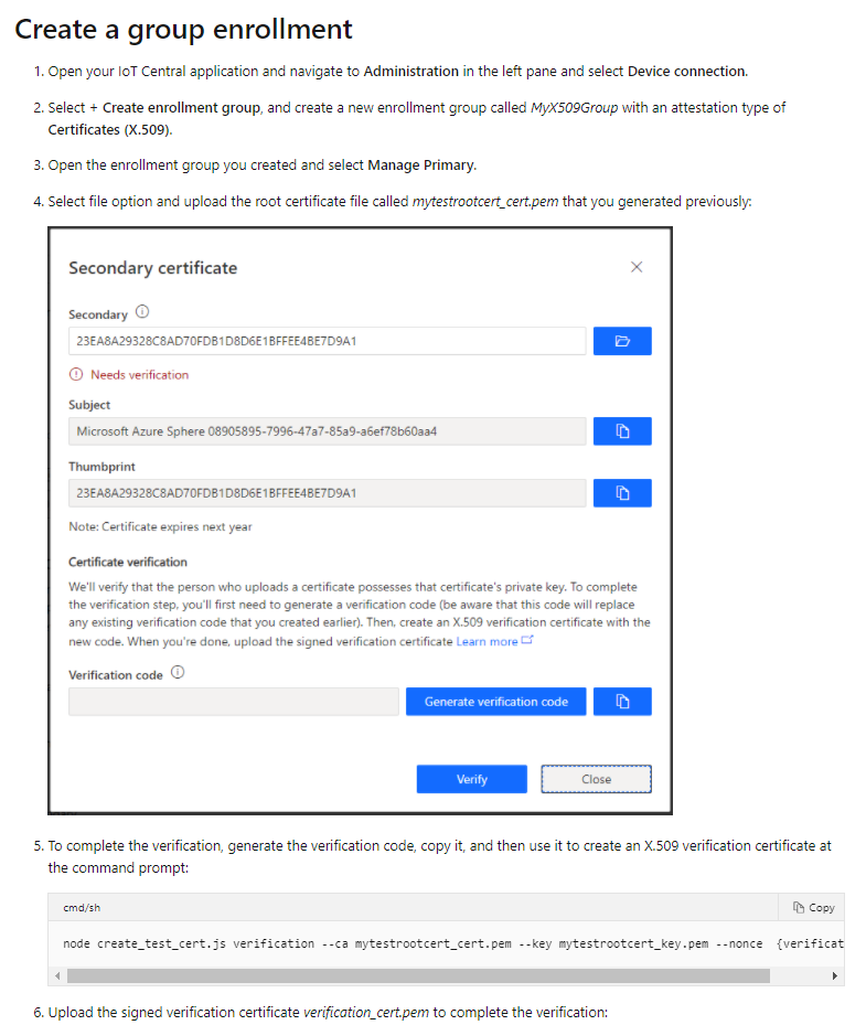

    To connect a device with an X.509 certificate to your application:
    1. Create an enrollment group that uses the Certificates (X.509) attestation type.
    2. Add and verify an intermediate (OR) root X.509 certificate in the enrollment group.
    3. Generate a leaf certificate from the root or intermediate certificate in the enrollment group. Send the leaf certificate from the device when it connects to your application.
    To learn more, see How to connect devices with X.509 certificates
