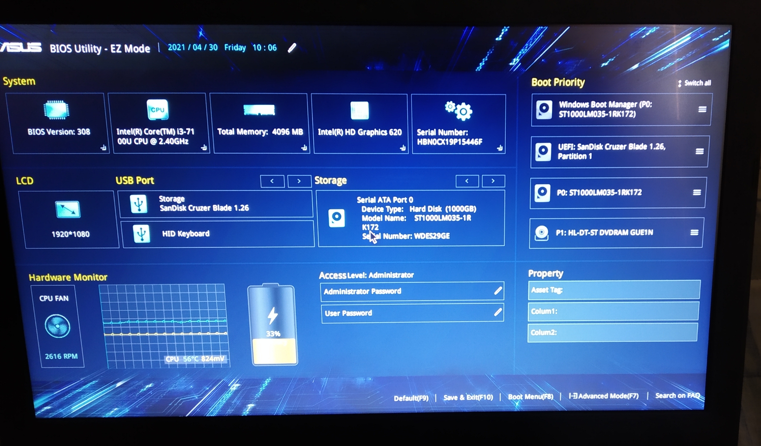

My laptop suddenly got stuck in automatic repair section. Startup repair, reset pc, image recovery noting is working.
Also, I checked that the diskpart command is only detecting the DVD ROM as vol 0. My hard drive is not showing up. So, I can't access any windows files to fix.
But my motherboard is still detecting my HDD.
  1. Jenny Feng 14,246 Reputation points
    2021-05-03T08:15:48.247+00:00
    BIOS will not be able to detect a hard disk when the hard drive data cable is damaged or improperly connected. If the serial ATA or SATA drivers are not properly installed, hard disk is not enabled in BIOS, hard drive keeps spinning up, or the hard drive is corrupted, failing or dying, BIOS may also fail to recognize your hard disk.

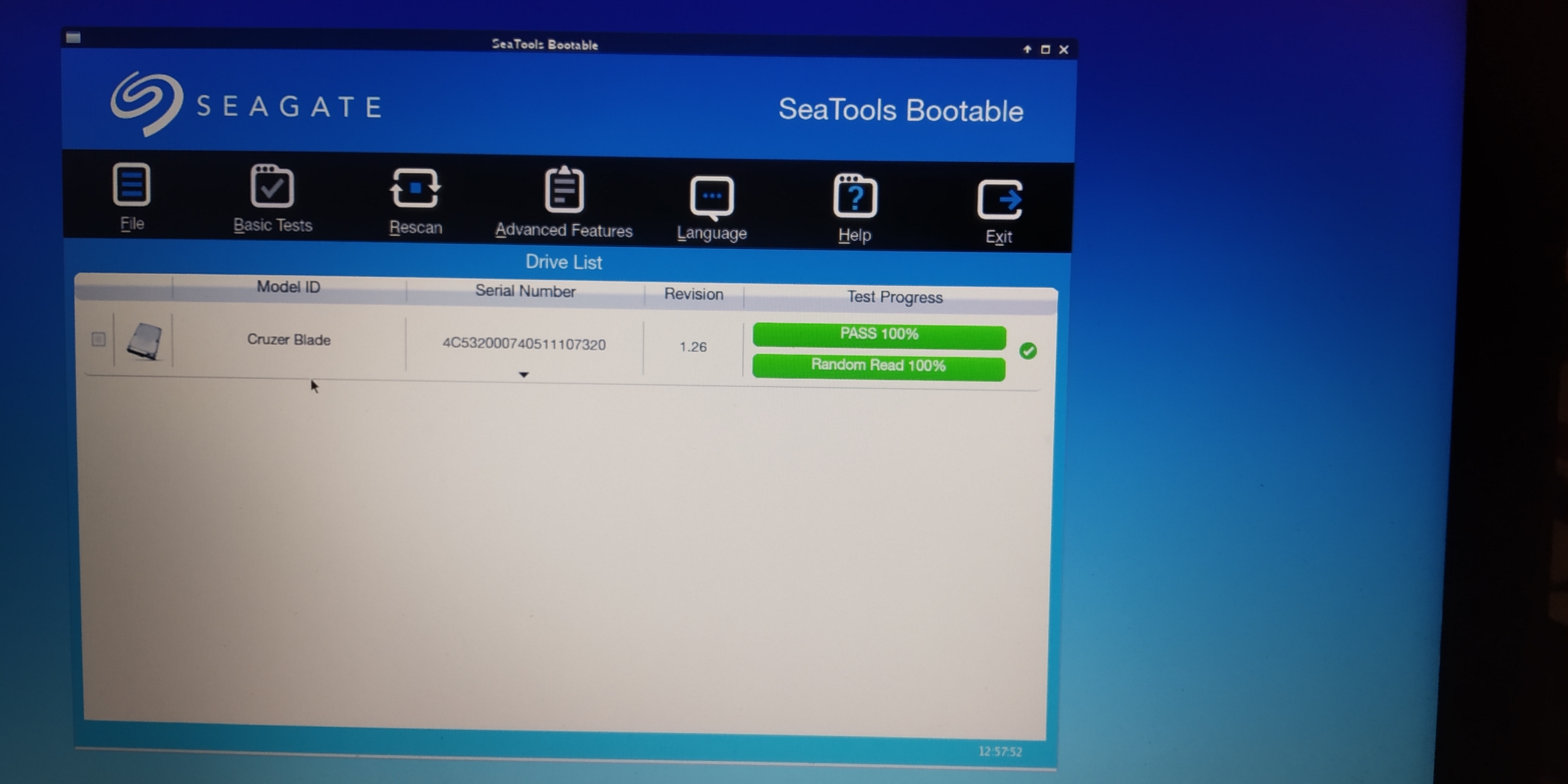

  2. Amit Mahato 46 Reputation points
    2021-05-02T07:33:14.197+00:00
    I tried seagate bootable, but here also I can only see my USB stick not the HDD..
