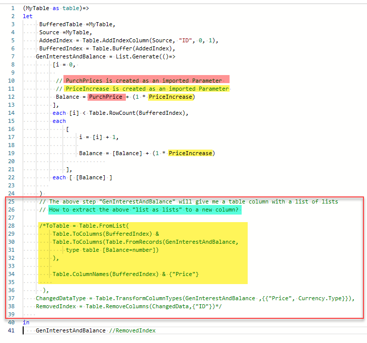

  2. Djpejsen 41 Reputation points
    2021-06-07T07:38:28.657+00:00
    Hi @Lz._
    I am trying to learn how to create the List.Generate based on the previous function `enter code here
     (MyTable as table)=>
        let
             BufferedTable =MyTable,
             Source =MyTable,
             AddedIndex = Table.AddIndexColumn(Source, "ID", 0, 1),
             BufferedIndex = Table.Buffer(AddedIndex),
            GenInterestAndBalance = List.Generate(()=>
                 [i = 0,
                  // PurchPrices is created as an imported Parameter
                  // PriceIncrease is created as an imported Parameter
                  Balance = PurchPrice + (1 * PriceIncrease)
                 each [i] < Table.RowCount(BufferedIndex),
                 each
                         i = [i] + 1,
                         Balance = [Balance] + (1 * PriceIncrease)
                 each [ [Balance] ]
             // The above step "GenInterestAndBalance" will give me a table column with a list of lists
             // How to extract the above "list as lists" to a new column?
             /*ToTable = Table.FromList(
                 Table.ToColumns(BufferedIndex) &
                 Table.ToColumns(Table.FromRecords(GenInterestAndBalance,
                     type table [Balance=number])
                 Table.ColumnNames(BufferedIndex) & {"Price"}
            ChangedDataType = Table.TransformColumnTypes(GenInterestAndBalance ,{<!-- -->{"Price", Currency.Type}}),
            RemovedIndex = Table.RemoveColumns(ChangedData,{"ID"})*/
        in
            GenInterestAndBalance //RemovedIndex
  3. Lz._ 9,016 Reputation points
    2021-06-07T09:18:48.757+00:00
    @Djpejsen
    Not sure what you exactly mean (what's expected) with "How to extract the above 'list as lists' to a new column". To a new column to what???
    Below code is available in this workbook. If you follow the steps with PQ Applied Steps hopefully this should answer your question. If not please open a separate thread with a demo table (few rows are enough) and what you expect once the list of prices increase has been generated

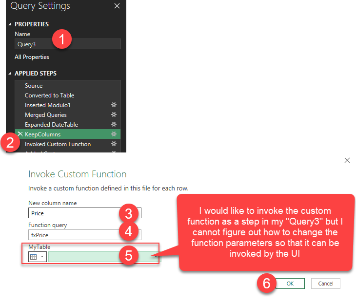

  4. Djpejsen 41 Reputation points
    2021-06-07T09:22:10.817+00:00
    Hi @Lz._
    Custom function
