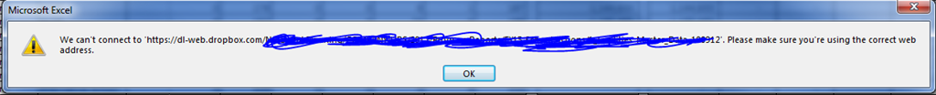

I have a large Excel 2013 file that I'm modifying. When I open the workbook I receive two types of errors about 4 times each:
Either:
a) Microsoft Excel cannot access the file https://dl-web.dropbox.com_________________. There are several possible reasons: The file name or path does not exist, the file is being used by another program, or the workbook you are trying to save has the same name as a currently open workbook.
or
b) We can't connect to 'https://dl-web.dropbox.com_____________________'. Please make sure you're using the correct web address.
I have nothing in "Edit Links" or "Existing Connections". How can I fix this so that I do not have to modify each computer that I pull this file up on?
How can I locate which cell is referencing this file in dropbox?
Thanks in advance!!

    2015-03-03T16:16:48+00:00
    Than you for your help.
    I started Excel in Safe Mode and I unchecked the only add-on (Smart View). I shut down Excel and opened the file with no add-ons present.
    I figured out my problem through the link you provided. It had to do with Name Manager. Once I deleted the old names that reference DropBox, I was able to get rid of the errors.
    Thanks again!
