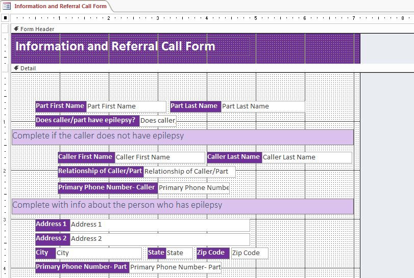

Here's what I see in design view:

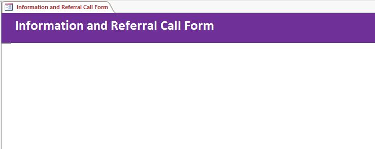

Here's what I see in Form View:
Nothing. Nada.
