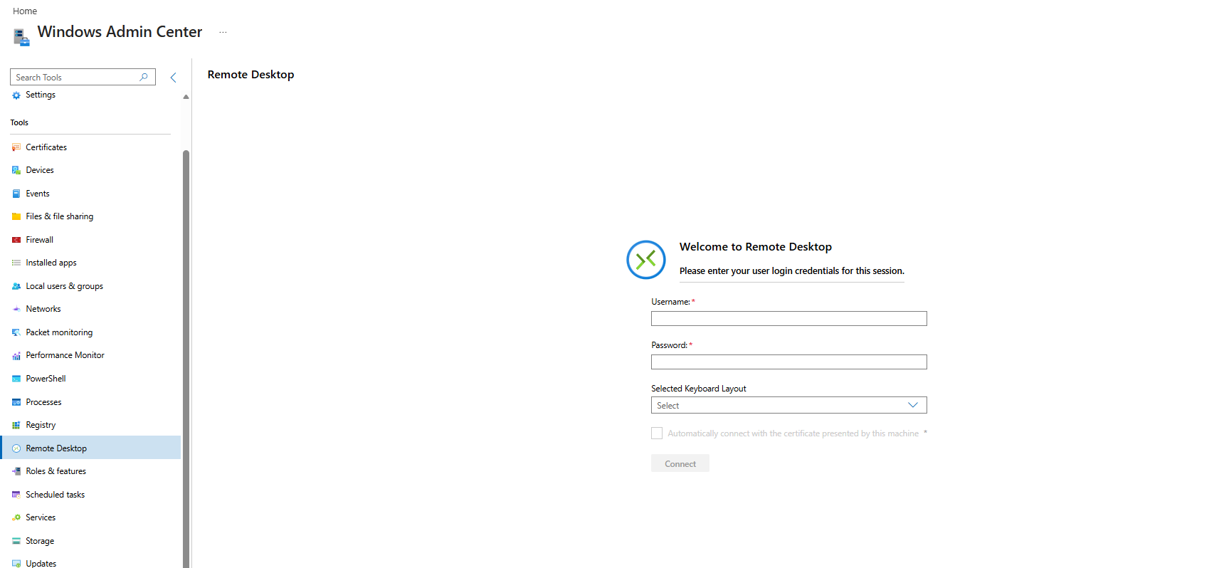

We set custom port for RDP, how we can connect thru admin center from portal azure if the RDP port is custom?

    Hello Handian, the built-in Windows Admin Center preview in the Azure Arc blade currently only spins up an RDP session to port 3389 – there’s no UI today to override that port. Since your box is now listening on 13389 only, the portal can’t reach it.

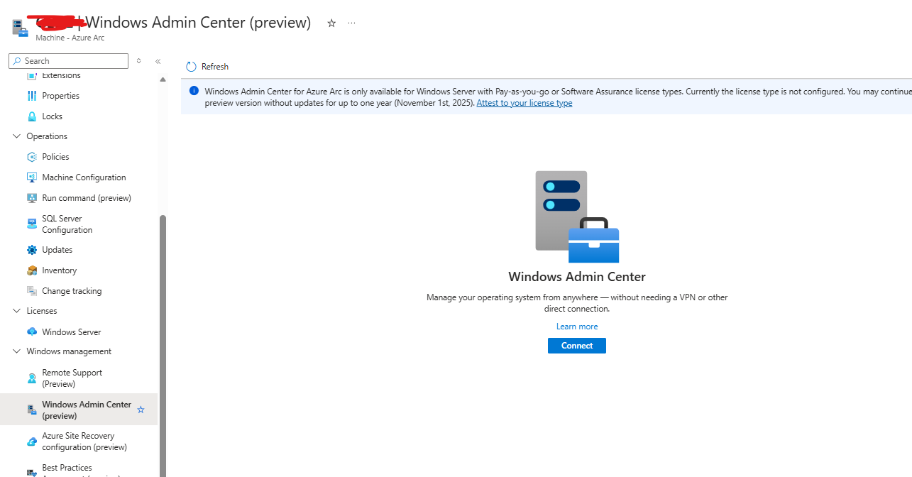

    3. Install and connect to WAC from the Azure portal
      • On the Arc-enabled server resource in the Azure portal:
        1. Go to Windows Admin Center under Settings.
        2. Install the Windows Admin Center extension and specify the desired WAC port.
        3. After installation, select Windows Admin Center (preview)Connect.
