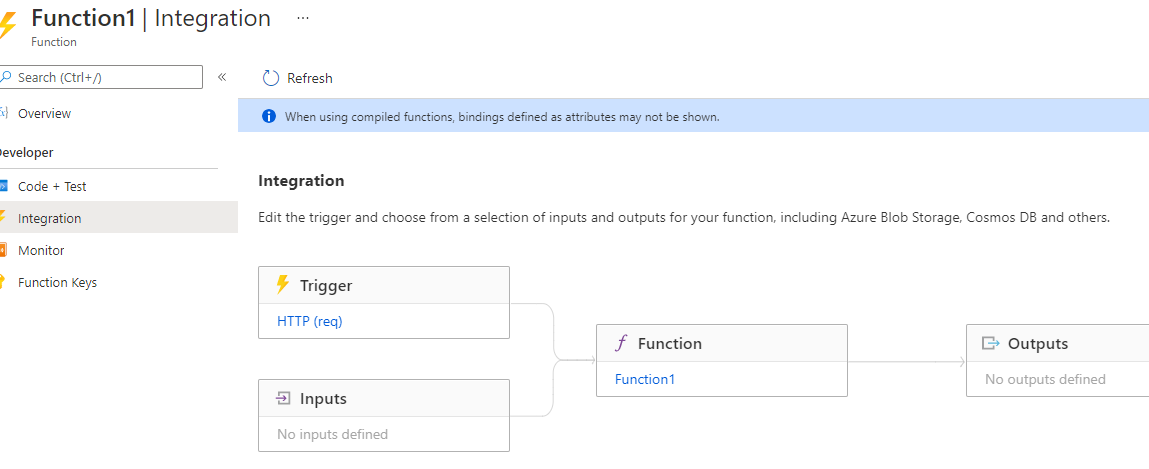

I was able to create a new solution using Visual Studio 2019 with Azure Function, and successfully published on the Azure portal.
So, my first test is passed.
Now, my challenge now is, I would like to use .NET SDK inside Azure Function solution.

    2021-11-09T12:45:09.24+00:00
    @MughundhanRaveendran-MSFT Thank you so much for your help.
    I have two more questions.
    1. Regardless of using Http Trigger or Timer Trigger, don't I have to use ADF to move data from Functions to Azure SQL?
      Is there any other way?
      I am guessing the difference is with Http Trigger, since it has a webhook, it automatically triggers ADF, but with Timer Trigger, we have to schedule ADF to run, no?
    2) If I use Timer Trigger, can I still apply the code/logic to pull data from a third party API using web services? I am not sure how Timer Trigger works/dies not work with web services.
