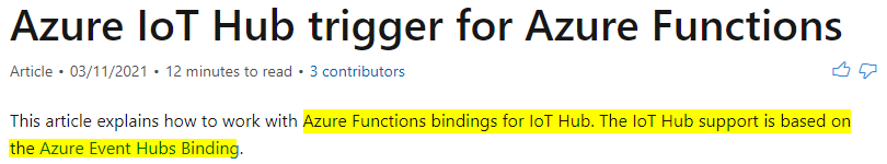

    According to this recent document (https://learn.microsoft.com/en-us/azure/azure-functions/functions-bindings-event-iot-trigger?tabs=csharp) it is suggesting to use the azure event hub binding for IOT

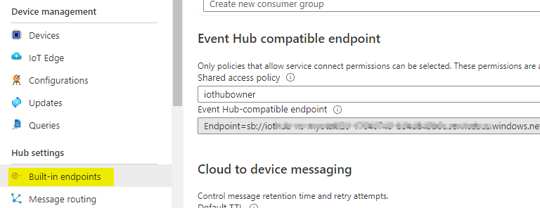

    The conn string for the trigger function (the one that goes in the local.settings.json )
    is this one here:

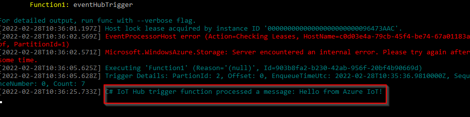

    **Debugging works fine. Received the message that I've sent **

    As you know, Azure functions are event based functions. The functions gets triggered based on events. Looking at the attached screenshot, you are running the functions in your local machine and host has started. You need to add/push an event to the IOT eventhub ( which you have configured in the connection string) so that the function gets triggered and the debugger will hit the debug point. Once you step over the the code, you will a message in the console called "Functions executing with invocation id".
