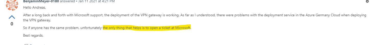

    There is a thread here on QnA with the similar problem and the only solution is open a support ticket with Microsoft (https://azure.microsoft.com/en-us/support/create-ticket/)
    Reference: https://learn.microsoft.com/en-us/answers/questions/210809/internal-error-when-creating-a-vpn-gateway.html

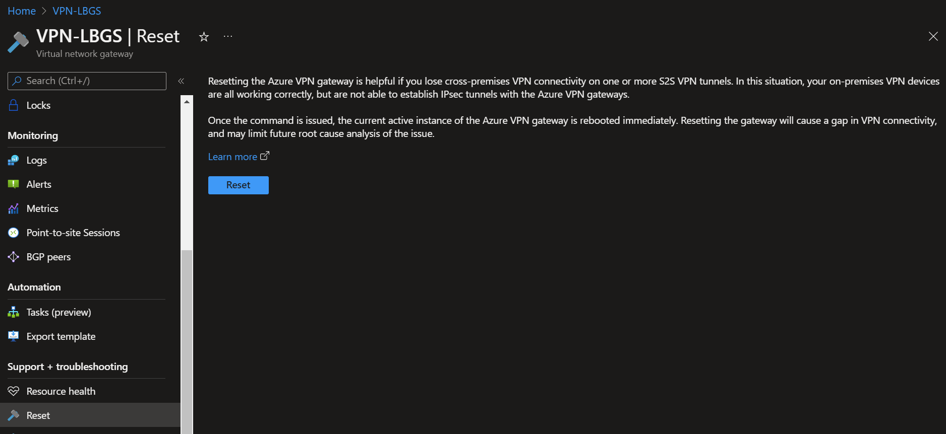

    You can try "Reset"

    Reset ofcourse also tried, no luck.
