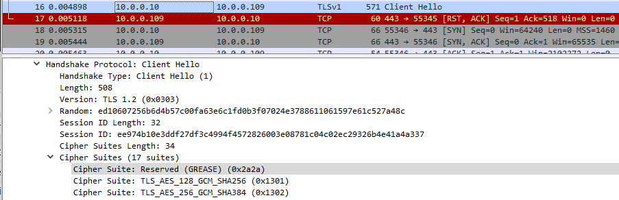

I ran across a strange issue while troubleshooting a new SharePoint 2019 web server deployment. After installing the IIS and SharePoint components, we were unable to connect to the server via HTTPS. We ran through the typical troubleshooting processes: verifying certificates had private keys, checking the cipher suite configuration, etc. A network capture showed the Client Hello, immediately followed by a TCP RESET from the server:
Interestingly, HTTPS sessions were successful using Internet Explorer. Again, looking at the network capture, one of the primary differences noted was that the IE 11 session did not include any GREASE extension in the Client Hello, whereas all of the modern browsers tested (Chrome, Edge, Firefox) did. Turning up the SChannel logging to the maximum level (7) in the registry, the server's system logs showed errors with Event ID 36888 and cited a fatal error code of 50 (decode_error). There were no other IIS or error logs to examine, as the server simply rejected the session.

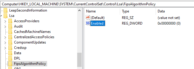

After combing through the policies applied to the server, the FIPS setting was identified as being the root cause of the problem. This was verified on a vanilla Server 2019 install running IIS as well. If you have the following registry key value set to disable FIPS, TLS handshakes will immediately fail when trying to connect with a modern browser:
Path - HKLM\SYSTEM\CurrentControlSet\Control\LSA\FipsAlgorithmPolicy
Key - Enabled
Value: 0
Setting the value to 1 to enable FIPS and rebooting fixed the TLS handshake issue. The problem is, SharePoint 2019 specifically states that FIPS must be disabled because there are components that are not FIPS compliant. After enabling FIPS, we noted exception errors when trying to manage SharePoint that read, "This implementation is not part of the Windows Platform FIPS validated cryptographic algorithms". We have already opened a ticket with MS, because this seems to be a catch-22. Either TLS works or SharePoint works, but we can't have both.
