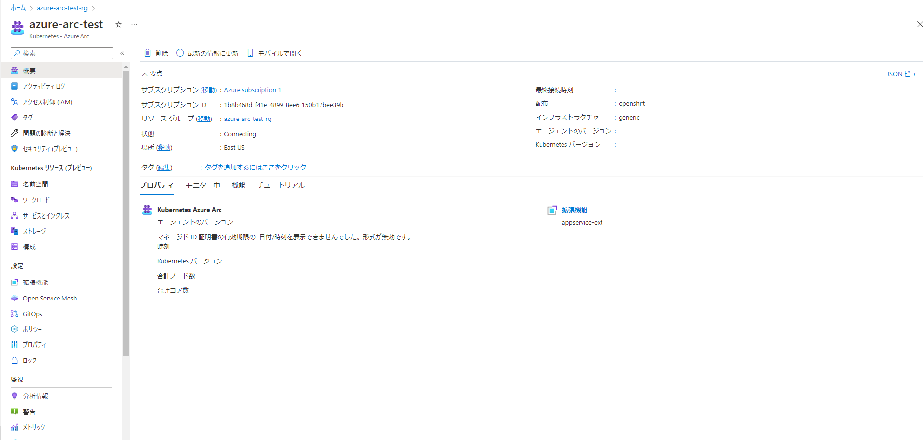

can't connect with openshift cluster and azure arc

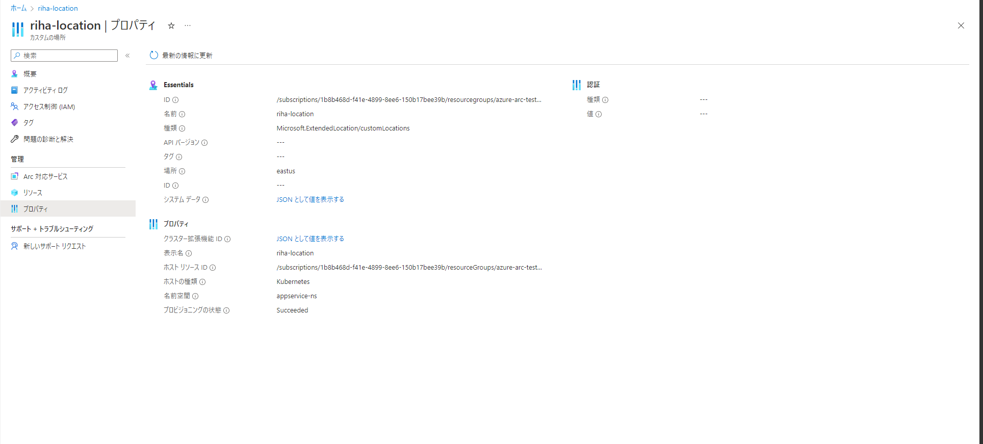

I want to connect the Openshift container platform built on-premises to Azure arc and deploy the application to Openshift on-premises via Azure arc.
I am doing it with reference to the tutorial, but an error occurred when I executed the following command.
■command
az appservice kube create --resource-group $resourceGroupName --name $clusterName --custom-location $customLocationId
■output error
Command group 'appservice kube' is in preview and under development. Reference and support levels: https://aka.ms/CLI_refstatus
Error occurred in request., RetryError: HTTPSConnectionPool(host='management.azure.com', port=443): Max retries exceeded with url: /subscriptions/<id>/resourceGroups/azure-arc-test-rg/providers/Microsoft.Web/kubeEnvironments/azure-arc-test?api-version=2020-12-01 (Caused by ResponseError('too many 504 error responses'))
how can i solve it

The status of the openshift cluster is as below
