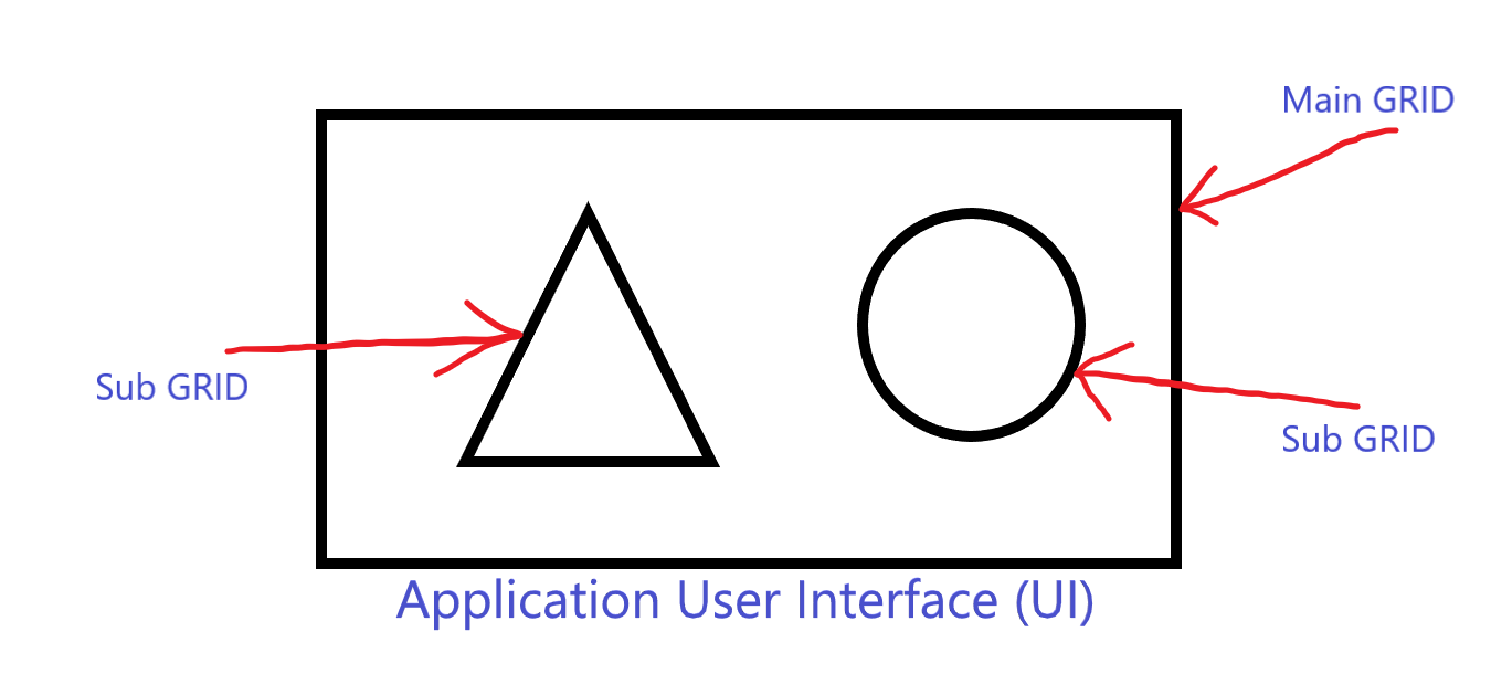

Let's assume that, I have a WPF application which is Rectangular in Size. That means the Main GRID is Rectangular. In this Rectangle, I have two another Grid. Which are the Sub Grid of that Main GRID. One Sub Grid is in Triangle shape and another is Circular. When the Mouse pointer enter in the region of Main Grid (which is Rectangular in Size) at that time the Mouse pointer speed should be 2x (Which is very first), now I just move my mouse and suddenly it enters in the Triangle shape Grid region and my mouse pointer speed became 3x which is very much slow as I said earlier. Now in the last, in same way if the pointer enters in the Circular Grid the pointer speed became 1x which is normal.
Another important point is, if the Sub Grid positions are complex then How we decide? which Level of Mouse Speed sensitivity we need to fire up when Mouse cursor are hover on them?

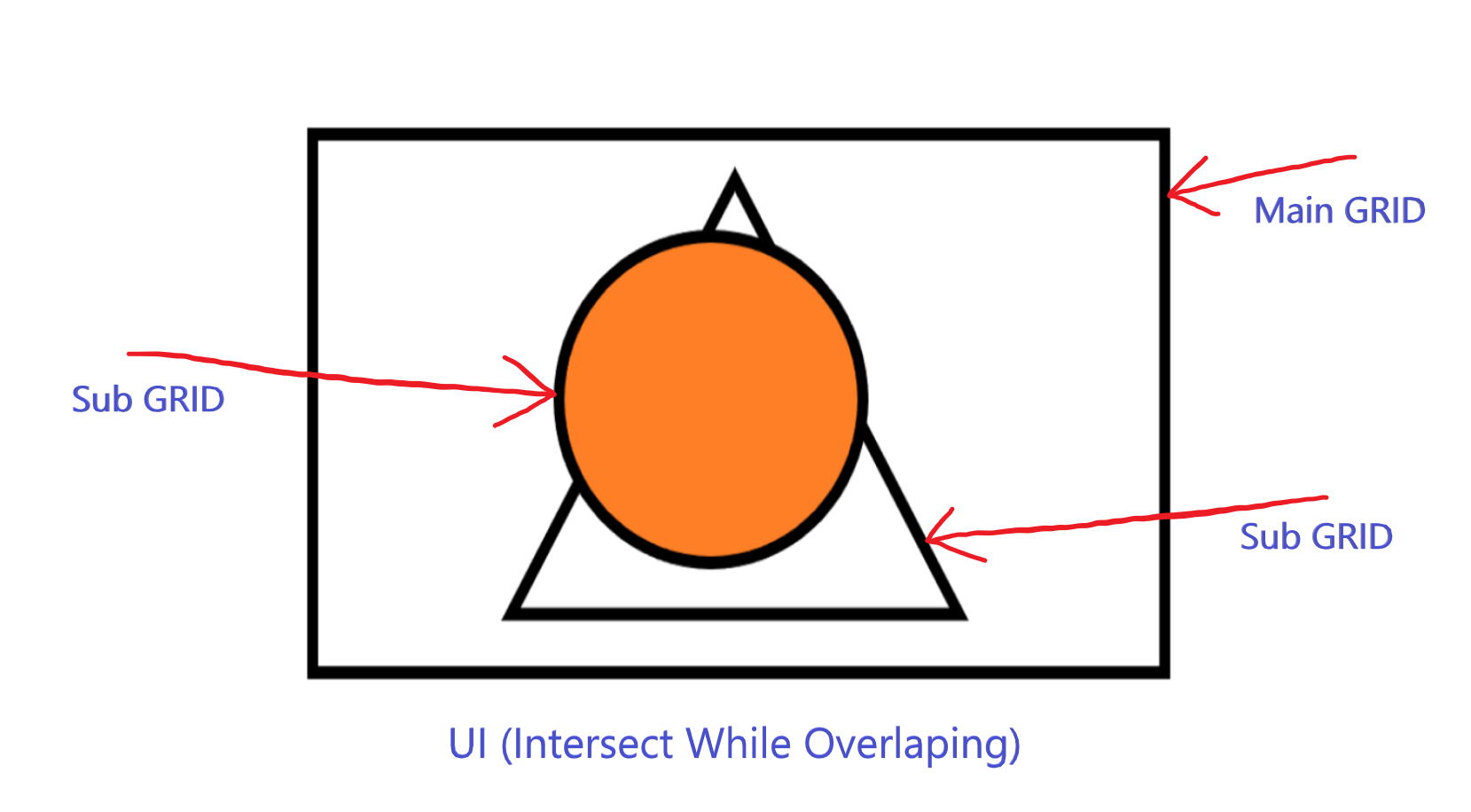

The Answer is very much simple that if there any intersect position of Grid present then we should give priority to the last applied Grid on this type of overlapping position.
I attach few set of images to understand it properly.mouse_SPEED -1
mouse_SPEED - 2
mouse_SPEED - 3
I highlighted the Last applied Grid which is in circular shape in this case with Orange color for better understanding.In a single sentence I want to modify the mouse speed sensitivity to every UI element (like - Grid, Stack panel, button etc ) of a WPF application.

    1. By default, WPF executes the event for the topmost control
    2. Refer to the example
    <Grid>
         <Grid.RowDefinitions>
             <RowDefinition Height="3*"/>
             <RowDefinition Height="*"/>
         </Grid.RowDefinitions>
         <Rectangle Name="rect1" Fill="SkyBlue" MouseMove="rect1_MouseMove" Width="200" Height="200" HorizontalAlignment="Center" Margin="0,0,0,0"/>
         <Ellipse Name="rect2" Fill="DarkOrange" MouseMove="rect2_MouseMove" Width="200" Height="200" HorizontalAlignment="Center" Margin="150,0,0,0"/>
         <Polygon Name="rect3"  Points="100,100 200,200 0,200" Stroke="Black"  MouseMove="rect3_MouseMove" StrokeThickness="2" Margin="350,0,0,0" Fill="YellowGreen"/>
         <TextBlock Grid.Row="1" Name="lblInfo"></TextBlock>
     </Grid>
