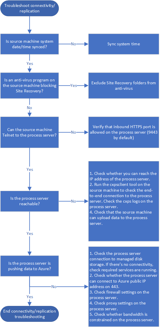

    Check connectivity and replication issues: https://learn.microsoft.com/en-us/azure/site-recovery/vmware-physical-azure-troubleshoot-process-server#check-connectivity-and-replication
    Flowchart showing steps to troubleshoot connectivity and replication.
    And also verify connectivity from the source machine:
    Install the Telnet client on the source machine if you need to. Don't use Ping.
    1. From the source machine, ping the process server on the HTTPS port with Telnet. By default 9443 is the HTTPS port for replication traffic. telnet <process server IP address> <port>
    2. Verify whether the connection is successful.
    I would advise going through all the relevant troubleshooting steps and see if you hit an issue which may solve the issue for that particular VM.
