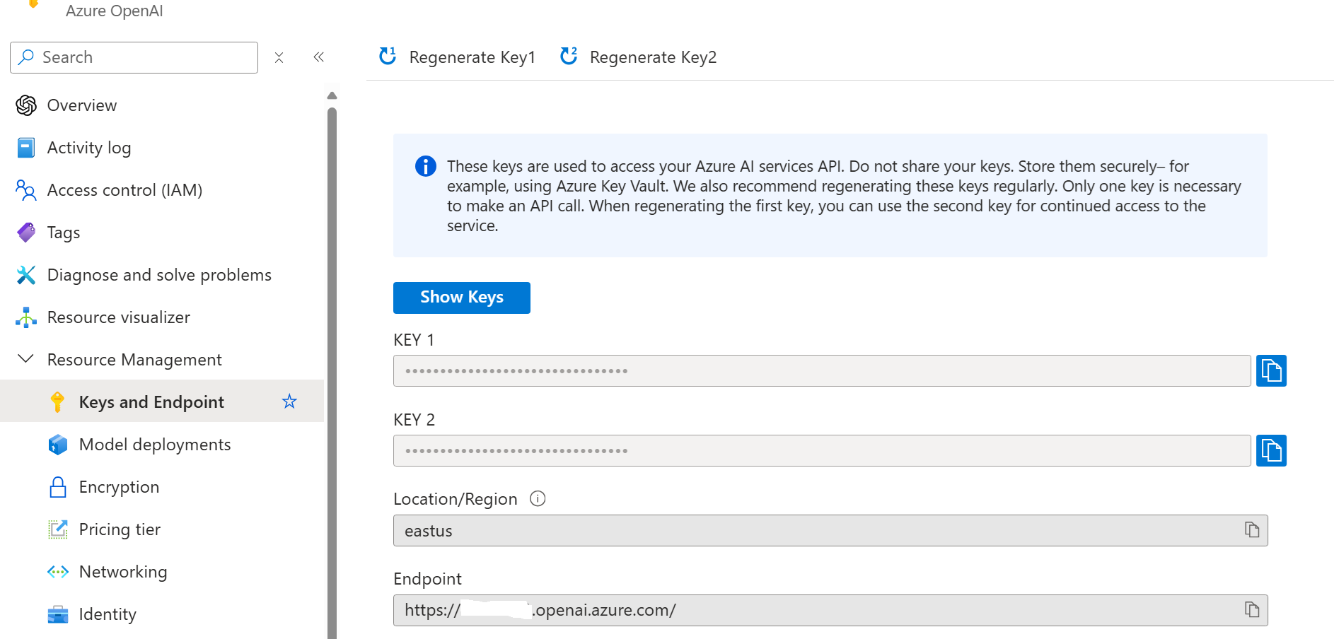

I got the key and endpoint from the 'Keys and Endpoint', but always run into below error:
Any suggestions would be appreciated.
