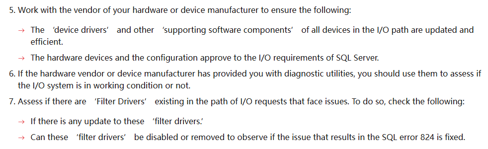

    In addition, please refer to this article, we can get the information below and it recommends use Stellar Repair for MS SQL to fix issue. The SQL Recovery software repairs corrupt SQL database files and recovers tables, indexes, keys, rules, constraints, triggers, and defaults. The understandable user interface of this software makes it possible to recover various objects present in MDF and NDF database files without much effort.:
    By the way, it seems that the second link you provided is expired. For your issue 'this does not address whether I/O subsystem latency causes database corruption'. I checked the official document of I/O fundamentals, it doesn't mention the information of I/O subsystem latency will cause database corruption and error message 824.
