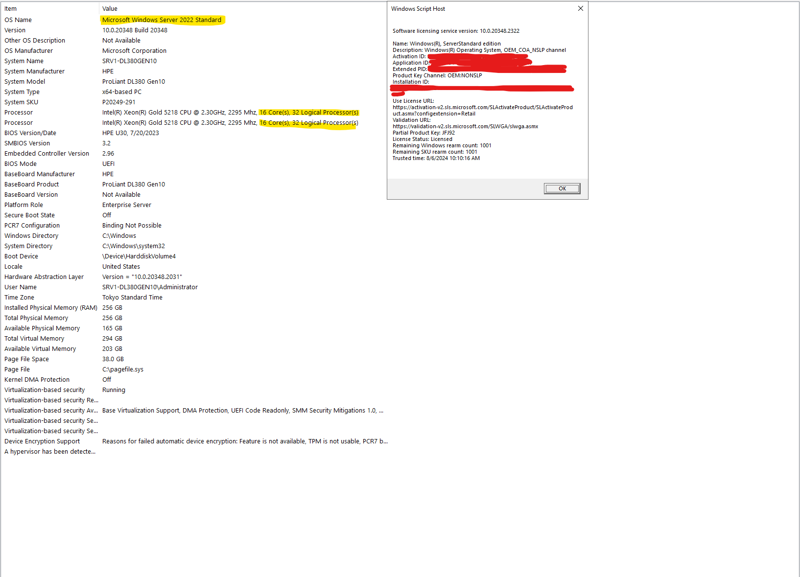

  3. Iakushev Georgii 0 Reputation points
    2024-08-06T01:41:38.7033333+00:00
    Hello @Konstantinos Passadis
    I just completed the suggested steps
    SLMGR.
    I have added a screenshot with the obtained information. However, I cannot find information regarding the licensing of all cores. I have the "Proof of License" with the tracking ID for the additional core license and the WinSer22 Standard ROK.Info_srv
    Additionally, when I try to activate the license from the HW Server (Hyper-V) on one of the VMs, I receive a message stating that the key is invalid.
  4. Konstantinos Passadis 19,596 Reputation points MVP
    2024-08-06T09:40:54.6566667+00:00
    Hello @Iakushev Georgii
    Thanks for the Input
    Based on the Screenshot i can assume you have licensed correclty all cores
