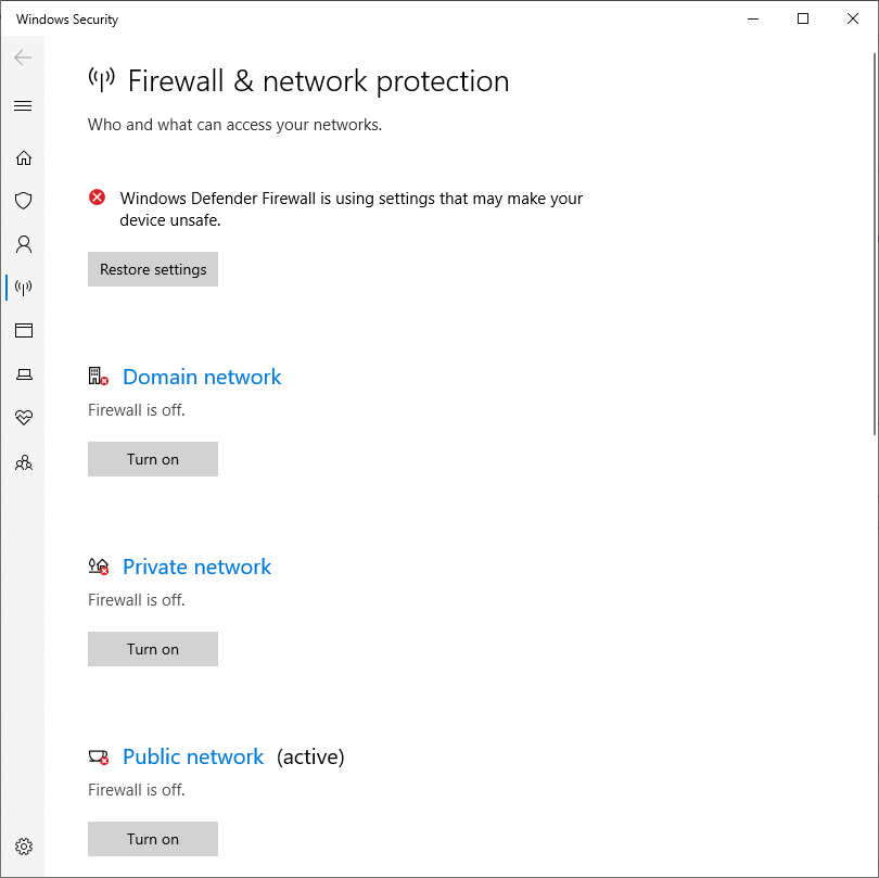

  2. d2o 21 Reputation points
    2020-12-08T03:57:51.997+00:00
    Thank you for helping
    Note that 192.168.50.200 is not my local machine IP address, it's a random IP address address
    The problem still occurs after I've disabled the firewall
    Regards
