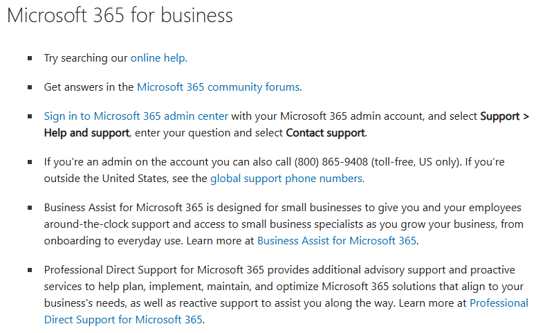

    Hi,@Anon4343
    M365 backend team can assist with an on-prem hybrid Exchange Server.
    Here's how to contact the M365 team:
    https://support.microsoft.com/en-us/topic/contact-microsoft-office-support-fd6bb40e-75b7-6f43-d6f9-c13d10850e77
