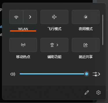

I need to programmatically control the state of the WLAN button (either turning it on or off). It doesn't matter whether it’s done through PowerShell or any other programming language, as long as it accomplishes the task.

However, this command makes the WLAN button invisible, essentially disabling the Wi-Fi adapter at the hardware level.

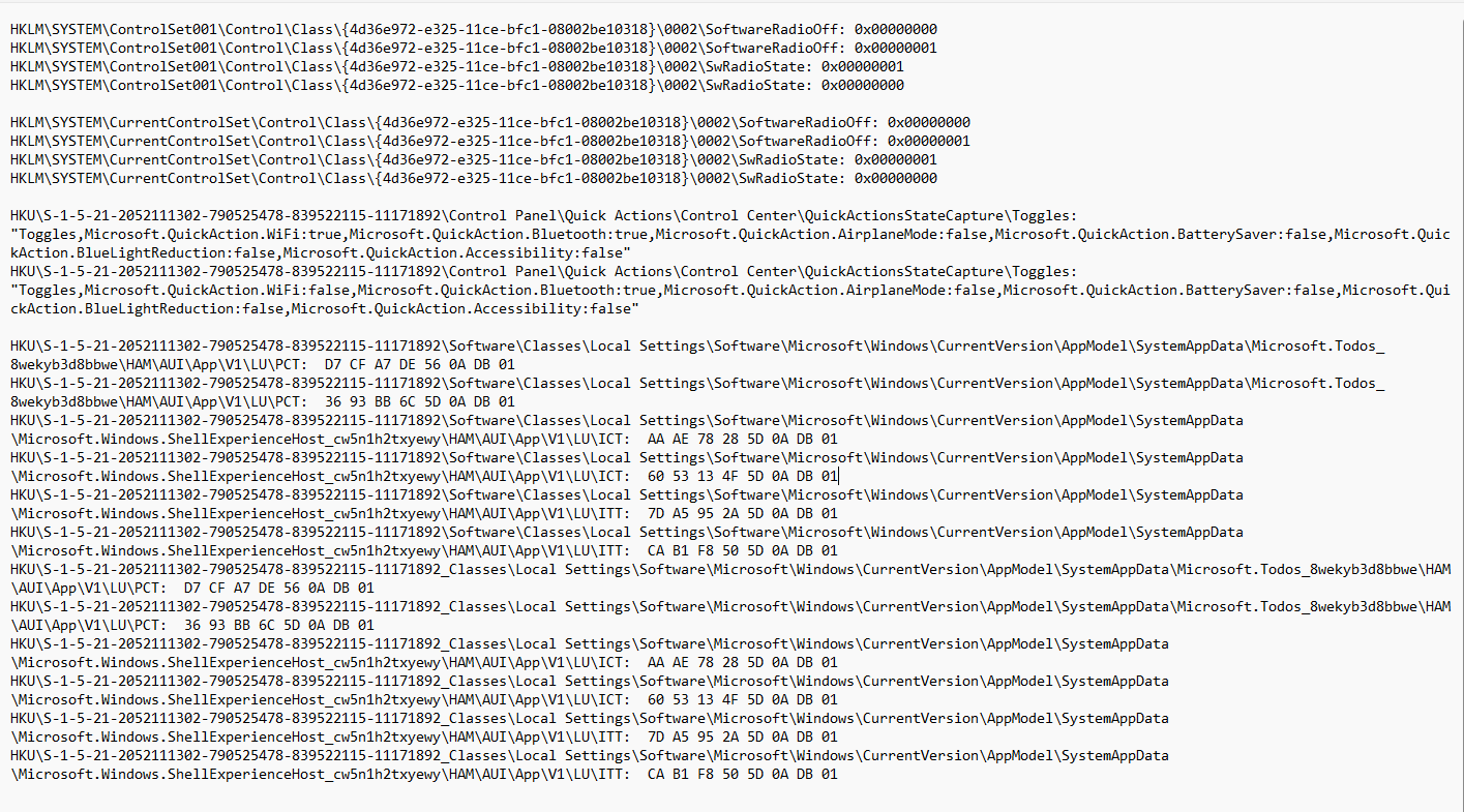

Afterwards, I tried using the software RegShot to compare the changes in the registry before and after turning off the WLAN button. I compiled a list of seemingly relevant changes and attempted to manually modify these entries in the registry, but it didn’t have any effect. Therefore, I suspect that clicking the button calls a function from a Windows DLL. Later, I found WlanRadioManager.dll and tried to decompile it using Ghidra, but my limited knowledge of C++ made it difficult to understand the code logic.
