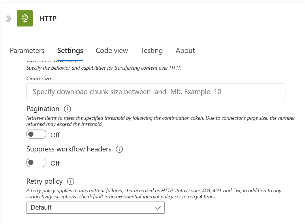

    Some of the Logic App triggers and actions have an option to enable the Retry mechanism. For example, an HTTP action has the following option which can be found under the action settings
    You can try and find a similar setting in either the trigger or the actions in your workflow and can try to configure this setting. You can refer the section Retry policy types for different options available.
