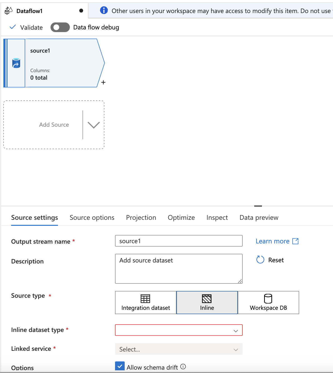

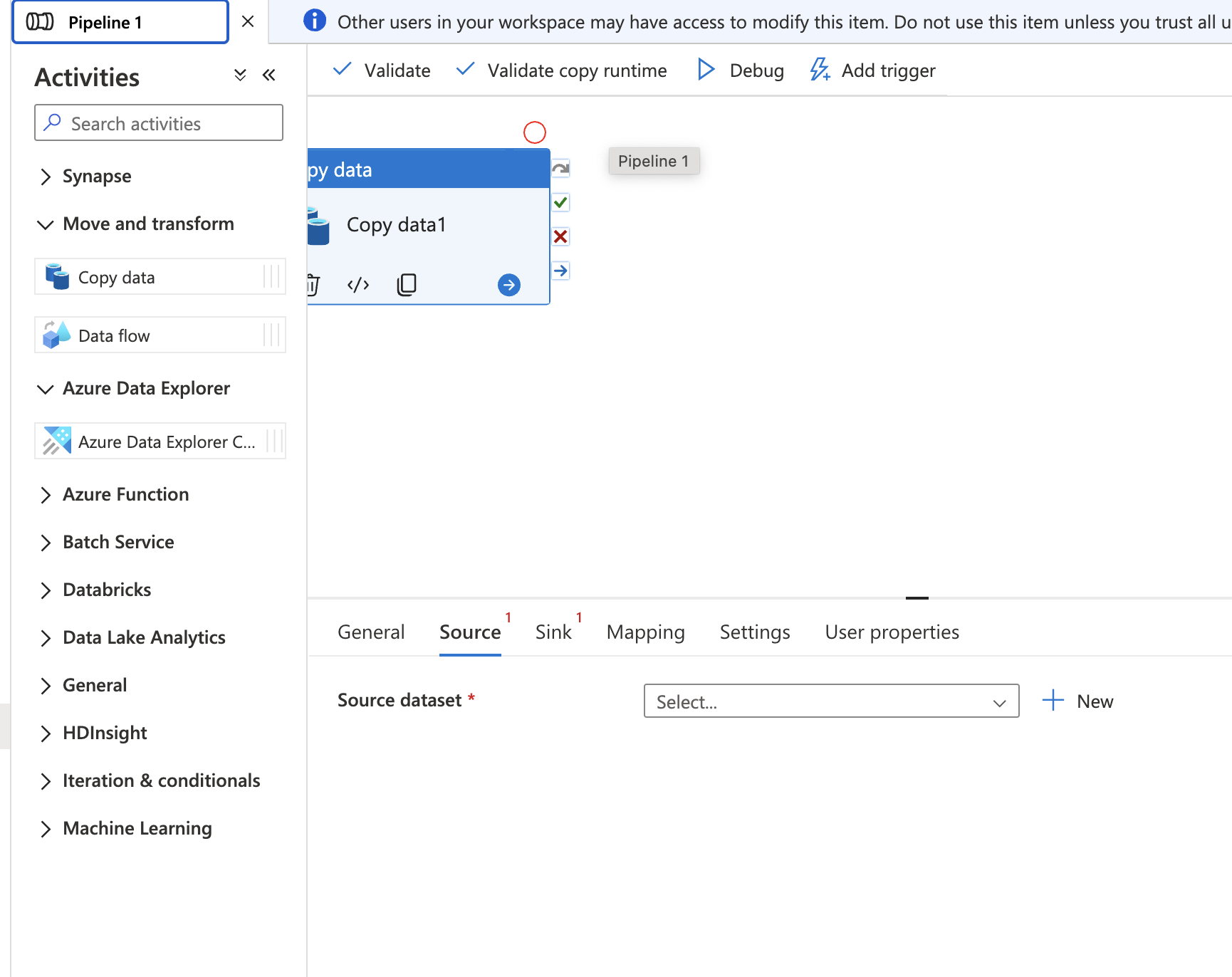

May I know if I can use Synapse pipeline or Data Flow to connect Eventhub and process Streaming data?
Pipeline:
Data Flow:
I try to use this visual programming to create a process to read streaming data from eventhub and join cosmos db etc. But I couldn't find 'Event Hub' source in either Pipeline or Data Flow. May I know if this is achiveable? Or both way can only process batching data from SQL pool, Storage, ADX, etc?

    Yes, you can process streaming data in Azure Synapse Analytics, but it is not directly achieved through Synapse pipelines or Synapse data flows for event-driven sources like Azure Event Hub. Synapse Pipelines and Data Flows are primarily built for batch processing rather than real-time streaming.
    However, Azure Synapse Analytics supports real-time processing of streaming data through Azure Stream Analytics (ASA) jobs or Apache Spark pools within Synapse. Here's how you can set it up:

    Why can't you find Event Hub in Synapse Pipelines/Data Flows?
    Currently, Synapse Pipelines and Data Flows do not natively support Event Hub as a source because they are designed primarily for batch data processing. While Synapse supports orchestration of streaming processes (for example, triggering Stream Analytics jobs), pipelines and data flows are not real-time data processing engines themselves.
