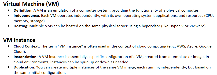

On the internet, I saw the difference in the image above- between a VM and a VM instance.
So, I infer from this that VMs have different OS systems and all of them operate independently.
But VM instances are templates or blueprints of a VM, that can be spun or downsized as needed. They also run independently but based on the same initial config that they got from the template.
==> Obviously VM instances are much faster than VMs because they are based on configs and don't need an OS or CPU and other resources unlike VMs. Please correct the above. Am I right?

    You are partially correct regarding VM and VM Instance. VM instances are templates or blueprints of a VM, that can be spun or downsized as needed but VM instances still require an operating system (OS), CPU, memory, storage, and other resources just like traditional virtual machines (VMs). The main distinction isn’t that they lack these resources but rather how they’re created and deployed.
