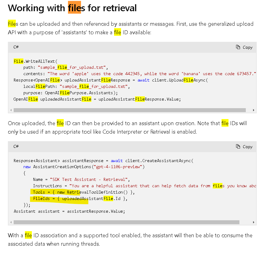

Seeking help getting the assistant to use the vector store using the library below:
Azure OpenAI: OpenAI Assistants client library for .NET - version 1.0.0-beta.4
For some context:
I've created a Vector store as well as an Assistant within Azure AI Foundry -> Azure OpenAI Service
Using the SDK (link above) and the assistantID I'm trying to run a thread but it's unable to do the file search.
Main Question: How do I hook up the vector store?
Any help is appreciated!
Thanks!
