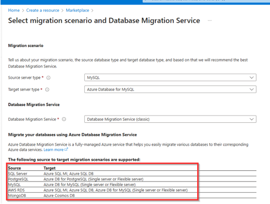

We selected the following Migration Scenario option set-up as the source for the data to be migrated is Maria DB on an Amazon RDS instance however the section highlighted in red shows that only SQL Server can be the source:

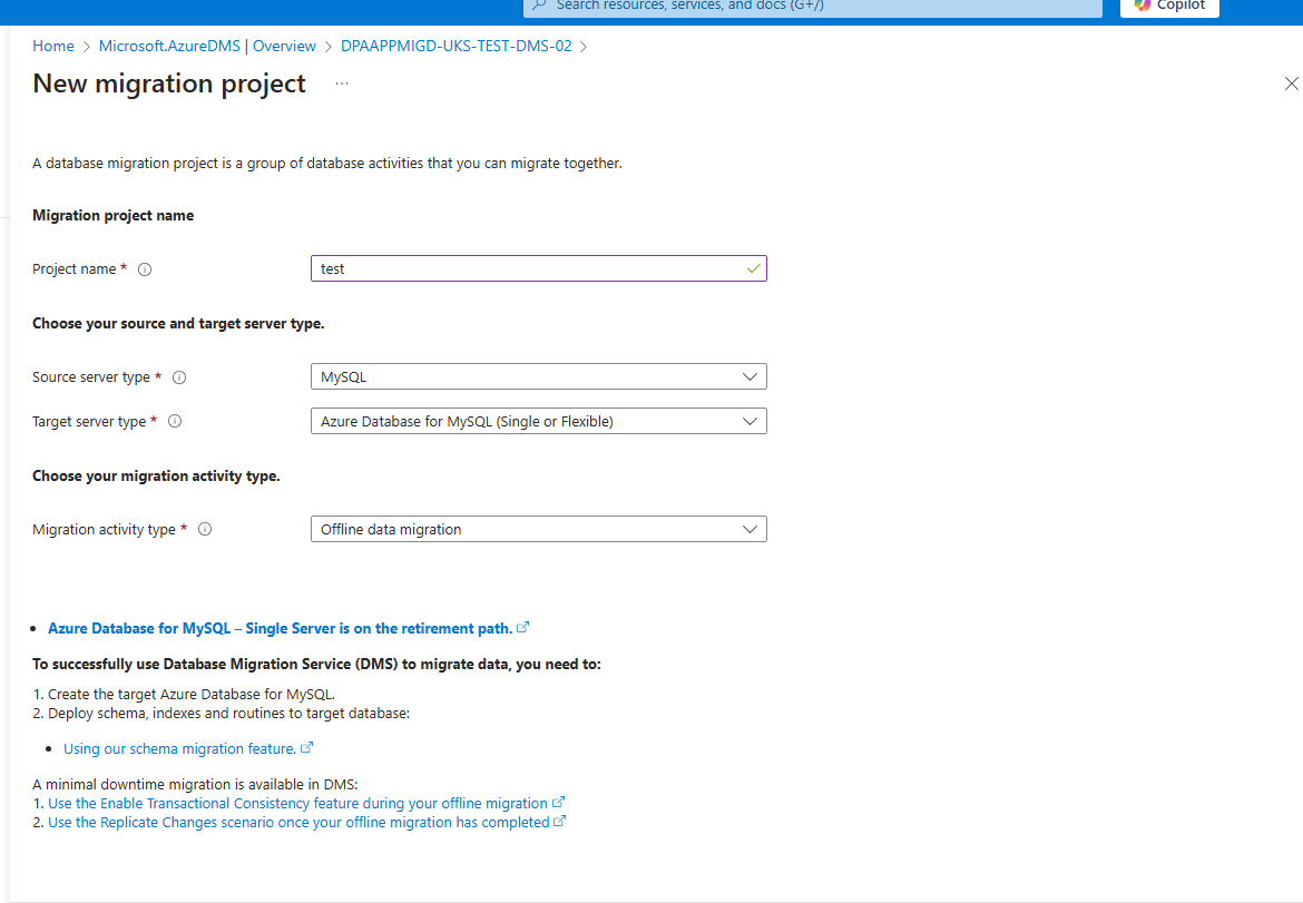

If we specify MySQL as the Migration Scenario Source Server (as per the below), more source and target options are supported including AWS RDS which I believe best fits our scenario:
However this has has created a slightly different menu but still only gives the MySQL -> Azure Database for MySQL (sing/flex) as an option for my SQL

  1. Oury Ba-MSFT 20,911 Reputation points Microsoft Employee Moderator
    2025-01-10T18:32:45.01+00:00
    Marc Hedgley Thank you for reaching out.
    In response also to your comment in this post https://learn.microsoft.com/en-us/answers/questions/2068303/guidance-with-mariadb-migration-to-azure
    DMS and DMS(classic) are two different versions of Azure Database Migration service where DMS(classic) being the legacy option. Currently DMS or DMS (classic) does not support migration from MySQL to SQL Server. However, SSMA (SQL server Migration Assistance for MySQL) can be used for the MySQL to SQL Server migration.
     Refer: https://learn.microsoft.com/en-us/sql/ssma/mysql/sql-server-migration-assistant-for-mysql-mysqltosql?view=sql-server-ver15
     Hope that helps.
