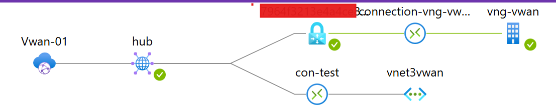

    I have set up the lab on my end and successfully pinged VM1 in VNet1 and VM3 in VNet3.
    I followed these steps as per Microsoft documentation:
    1. Configure VPN Gateway virtual network gateway.
    2. Create Virtual WAN VPN sites.
    3. Connect sites to the virtual hub.
    4. Create the local network gateways.
    5. In the local network gateway create connections.
    Refer this Microsoft Doc: https://learn.microsoft.com/en-us/azure/virtual-wan/connect-virtual-network-gateway-vwan.
    And

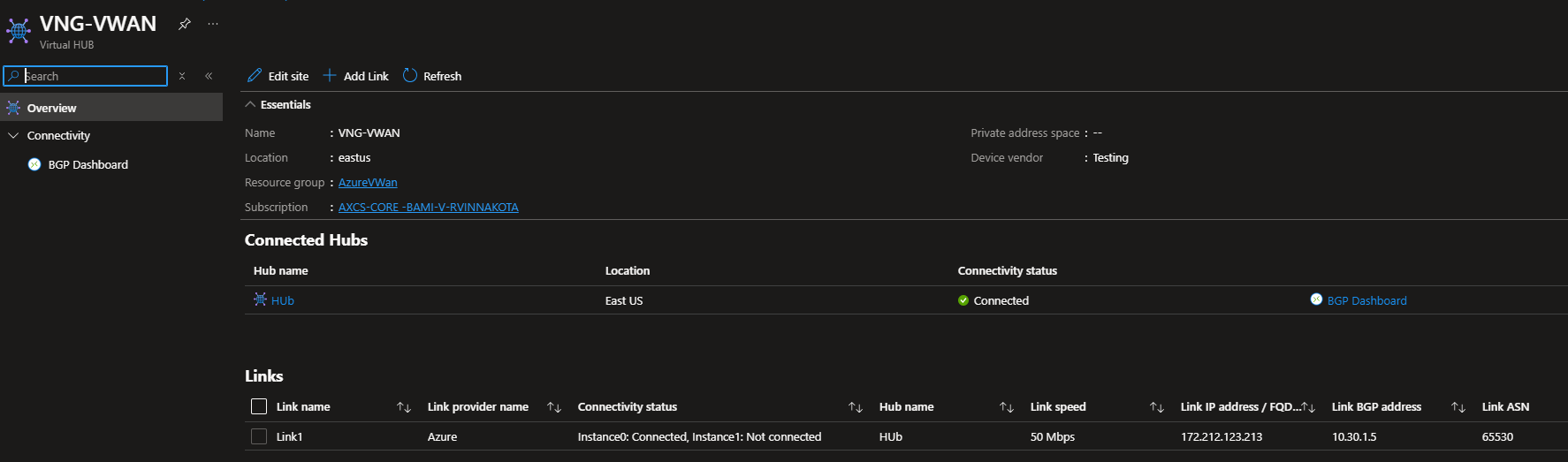

    • Can also check you configured the correct BGP peer IP address and ASN.
    • Check the connectivity status of the VPN site is connected or not.
    This my topology. User's image
    If above is unclear and/or you are unsure about something add a comment below.
